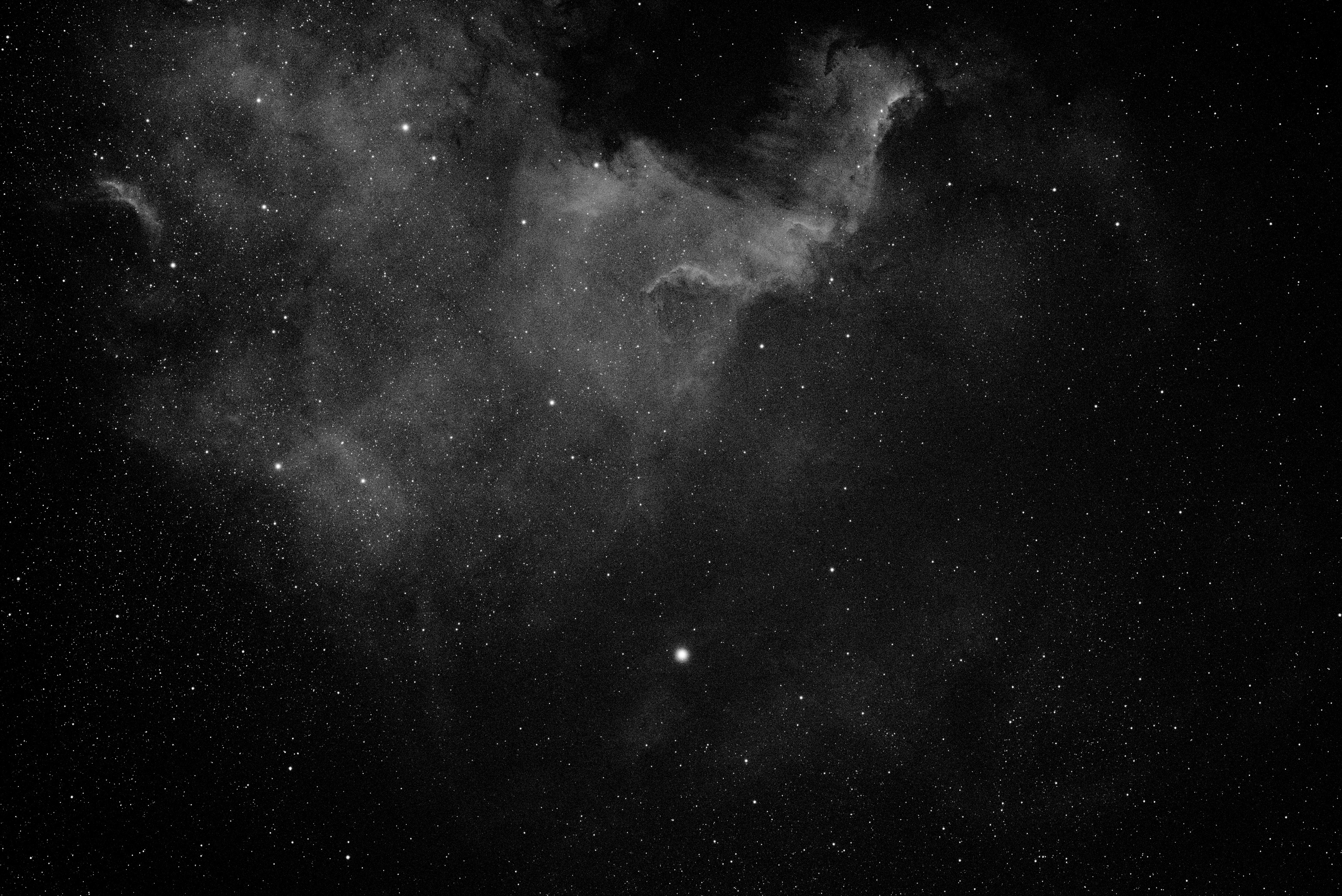

I took this last night when trying to experiment with a stack of an OSC narrow band filter (a Radian Quad) with a cheap LRGB filter to select between the narrow bands on a monochrome camera (ASI2600MM).  Since I was not seriously doing any imaging (I was just checking for the halos around a bright star, in this case of Xi Cyg) I just let ASIAIR do the auto-focusing last night.
So ASIAIR is at least capable of this degree of focus (single 180s exposure at gain 100, with a stack of a cheap Antlia L filter and the Radian Quad):
http://www.w7ay.net/site/Images/XiCyg.JPG
It is probably 10 µm off true focus.   The image covers a full APS-C frame.
