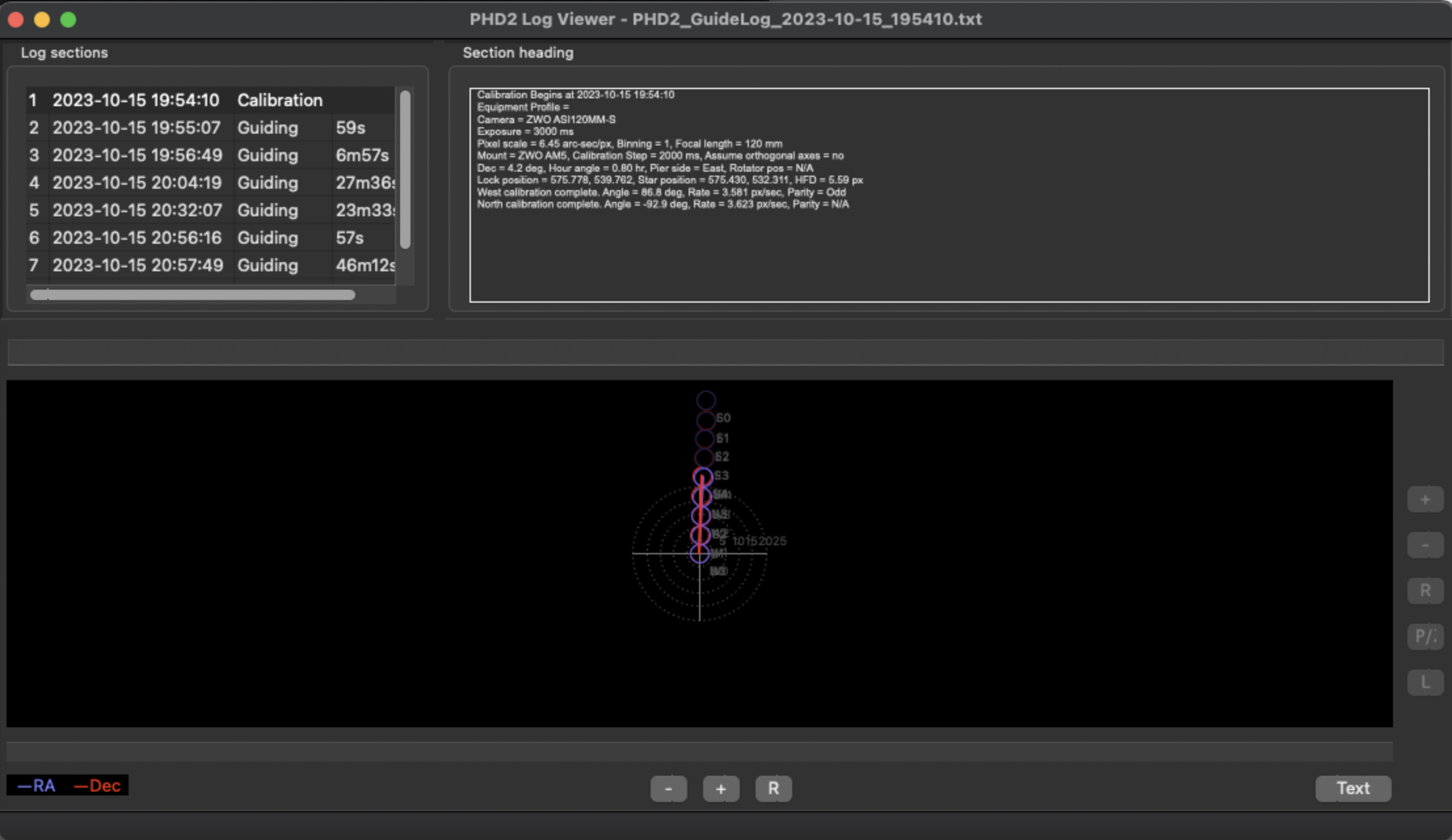

Mbartd That's strange the two calibration lines almost overlap.
