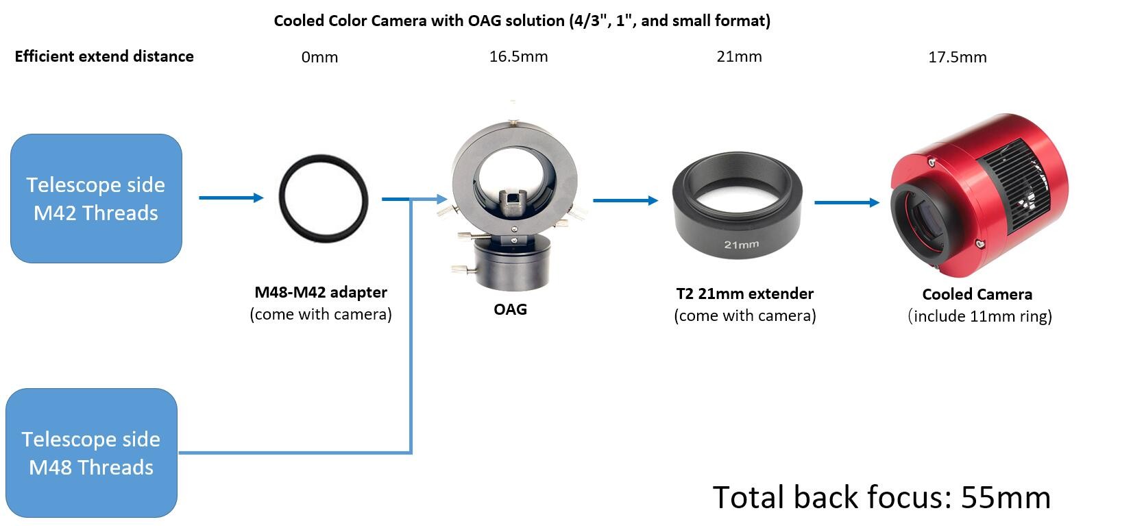

I just received the FF80, ASI533MC and ZWO OAG w/120Mini. Does anyone have a diagram on which adapters to use to hook up camera?
The FF80 does not need a specific backfocus but this will work. If you wish to use a filter drawer then substitute the 21mm extender spacer with it.
