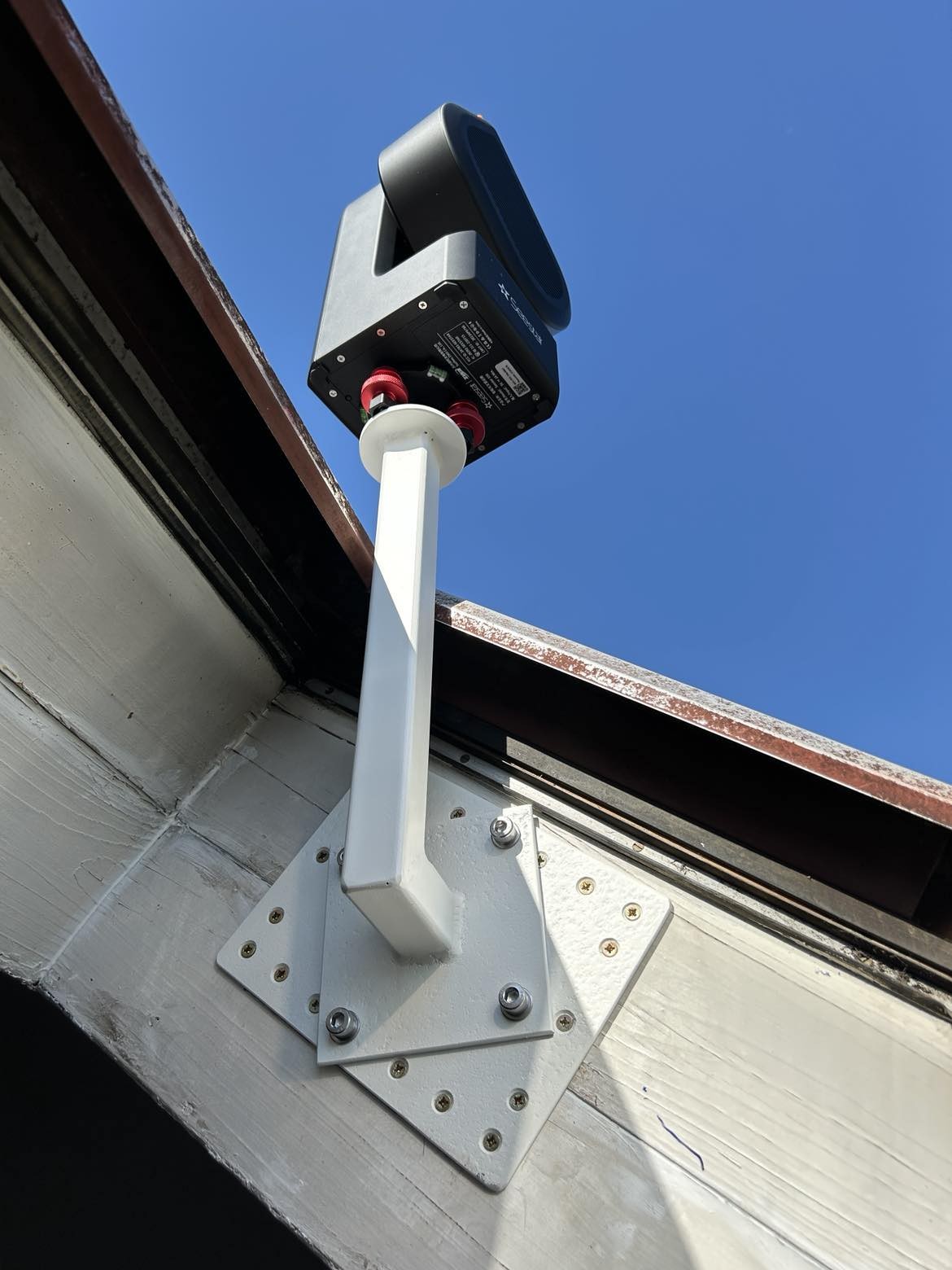

                LA3QMA Actually I have no clue. But my "tripod" is solid as hell. ๐Ÿ™‚ I created a very solid iron arm in the skylight. It can hold over 100 kilos without bending even a tiny bit. I guess this is one secret of my very low frame rejection rate.

                  Gulyas K Nice setup. But i do think that users can have it connected to the scope to loose or to tight even if the tripod is rock solid. I had this issue with a Meade ETX80. And also a similar issue with my Celestron Advanced VX. Anyhow i still use my S50 much more than my Skymax 127. Think of it i dont remember the last time i bothered to setup the celestron/skymax lol.
                    LA3QMA Same here! I have a C11 on AZEQ6 in my roller roof home observarory. But I'm a lazy s*it and it's more simple to use Seestar than the big gear. ๐Ÿ™‚
