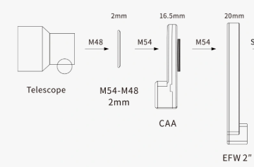

The ZWO CAA is 16.5mm thick, so take 55mm - 16.5mm = 38.5mm, so take your camera sensor which is 17.5mm includes 11mm t-ring and 6.5mm to sensor (17.5mm) so 38.5 - 17.5 = 21 and your 2" filter wheel is 20mm so that's 1mm and maybe a 1mm spacer maybe needed? But this should be very close to the 55mm back focus..
