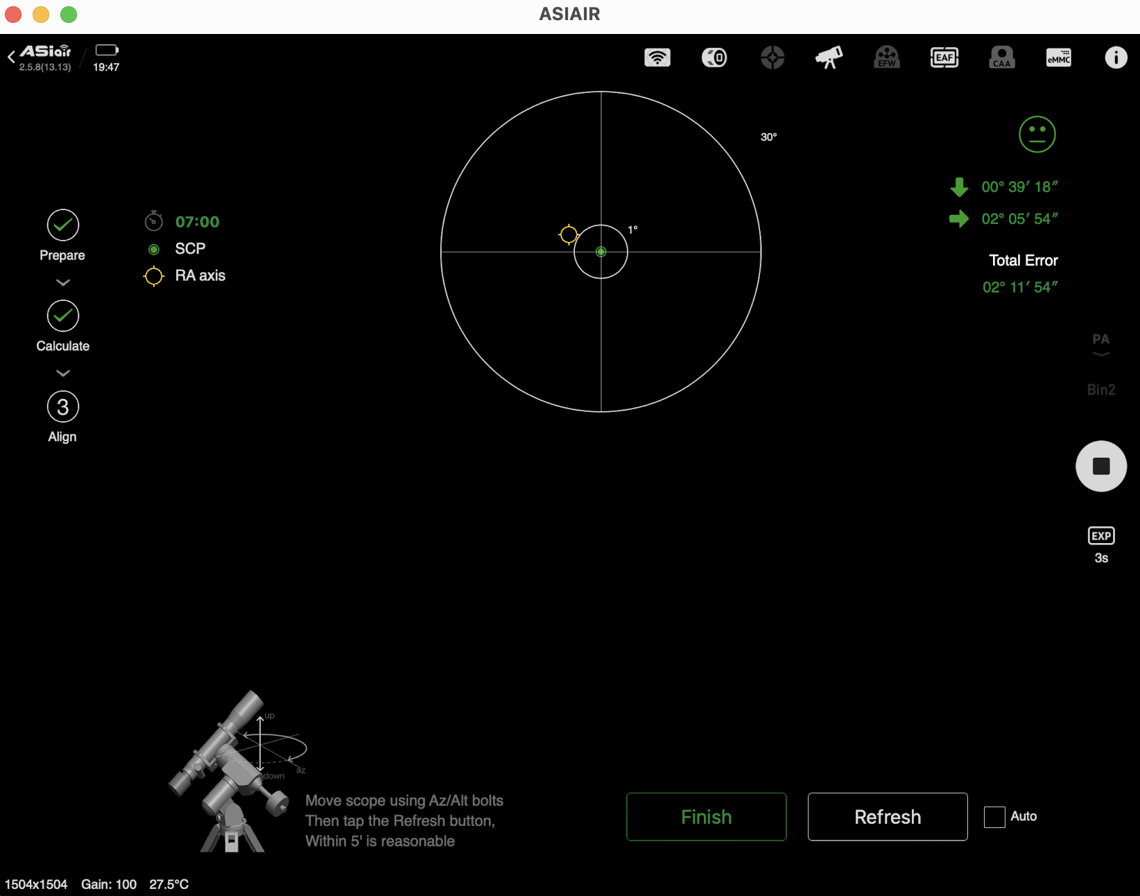

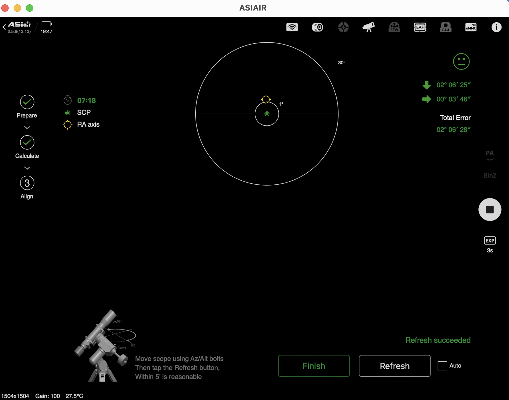

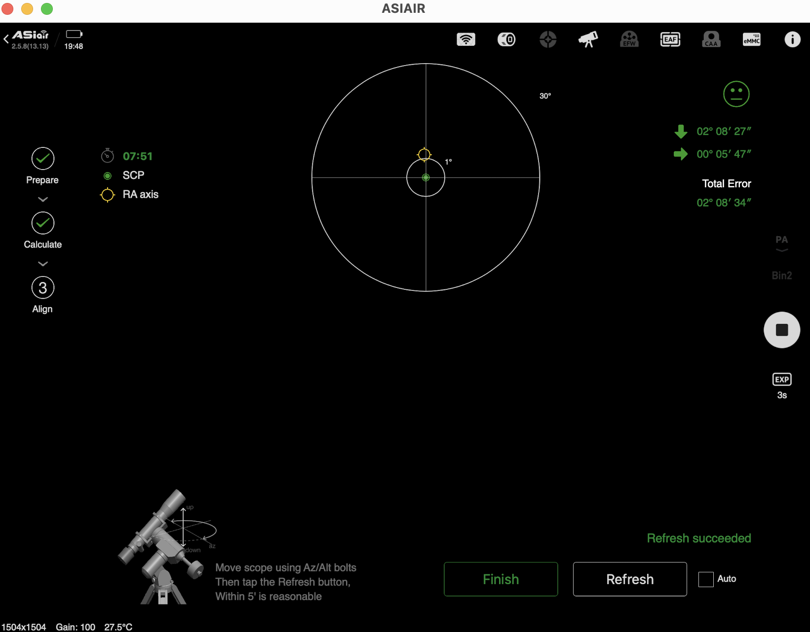

My experience had been similar to others – on first ‘refresh’ without any physical adjustment to the mount, the polar deviation values were different from those after ‘calculate’; on each subsequent ‘refresh’, the deviation values seemed to get progressively larger.
However the other night, I noticed a change in the pattern. The different deviation values (around 2 degrees in this case) still occurred after the initial ‘refresh’; but on each subsequent ‘refresh’, the values remained quite close (within around 2 arc minutes) to those initial values – and this margin is probably to be expected given that the ASPA methodology is an approximation (ie mathematically imperfect).
The attached screenshots show the base ‘calculate’ values, the initial ‘refresh’, and some subsequent ‘refreshes’.
