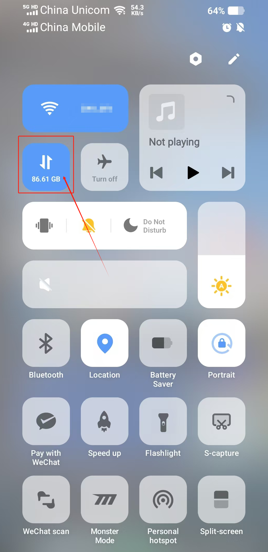

      For the first point, you can enable mobile data on your phone to connect to the internet using your cellular network.
