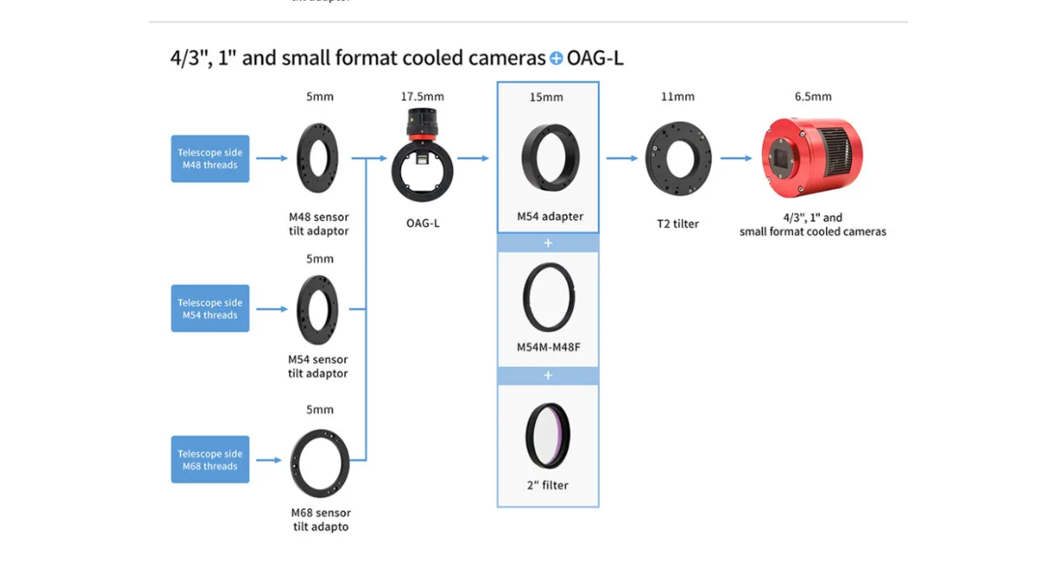

Hi, I have OAG-L and 4/3 format camera like ASI294. I don't have a Electronic filter wheel. Can you please advise how I can connect the OAG-L to this 4/3 format camera, without the EFW?
Thanks.
Looking at this page -> https://www.zwoastro.com/product/zwo-70mm-diameter-m54-adapter-for-oag-l-and-asi-dso-cameras/, I have follow-up query:
T3fqn7Tx Refer to this pic, you need to remove the 11mm adapter that come with the camera.
