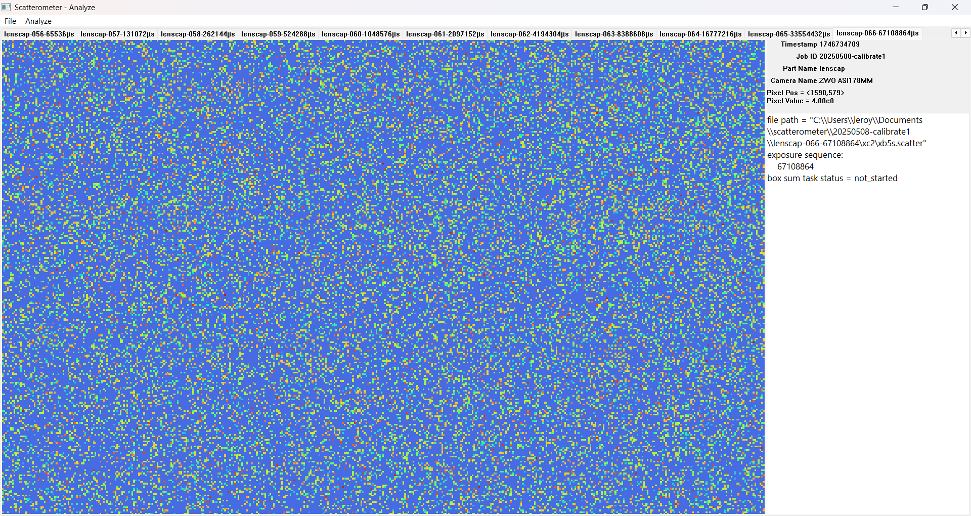

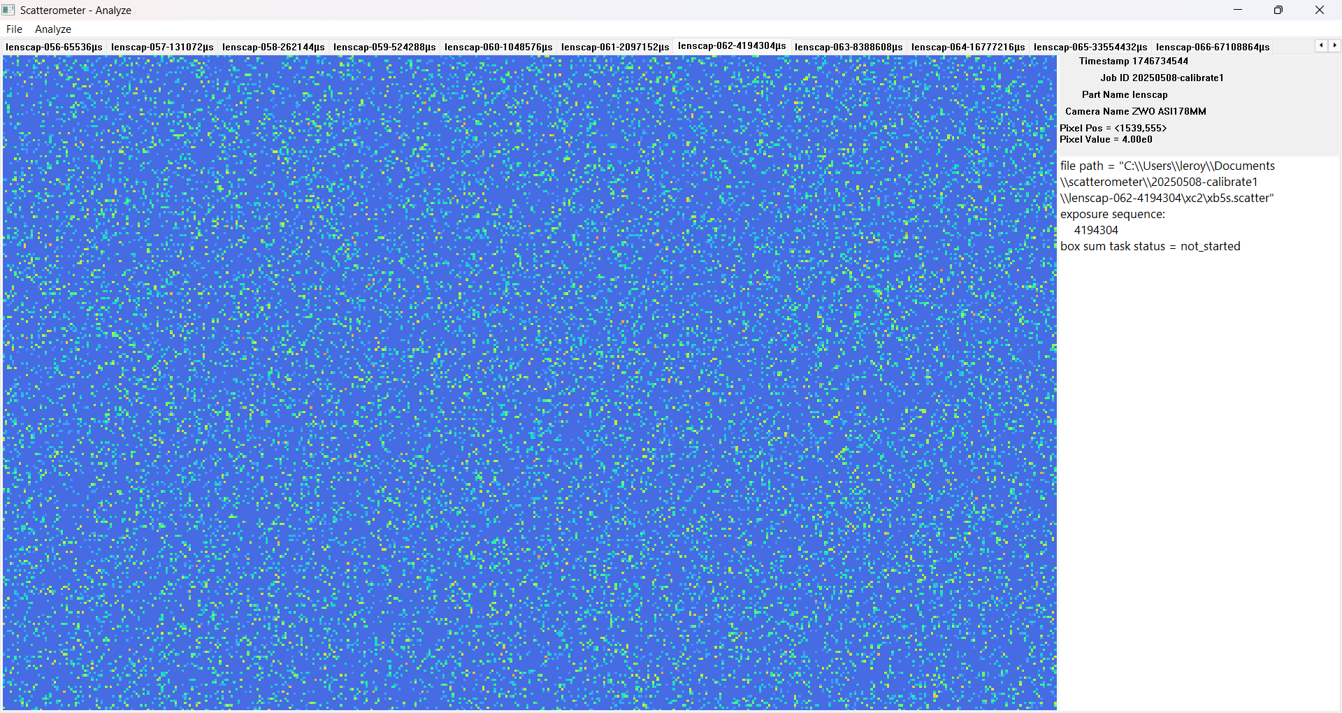

To be clear about what I am talking about, consider these 4 screenshots of exposures from 65ms to 524ms:
A light blue haze can been throughout these images. This haze is consistently in images from 32µs up to about 1 second.
Compare with these screenshots of exposures from 1.048s to 67s:
The haze is present but reduced in the 1.048s exposure, but by the last exposure at 67s the haze has all but disappeared.
