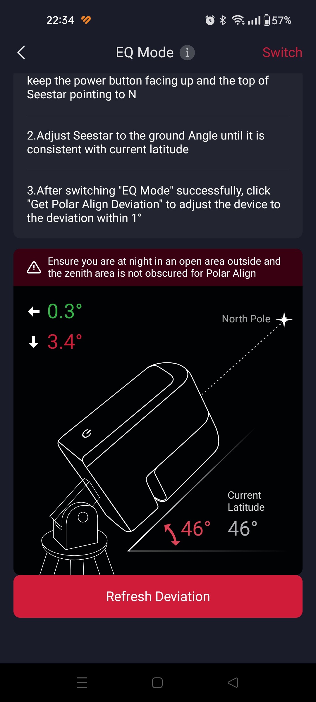

Updates? Now eq mode for me is unusable
Edit.
I found the error
Switch to alt az mode and than do a lever sensor calibration, seestar must be on a leveled surface
Latitude now comes back 90° with seestar on a leveled surface (before that was 86°)
I think this is a bug of the new firmware
