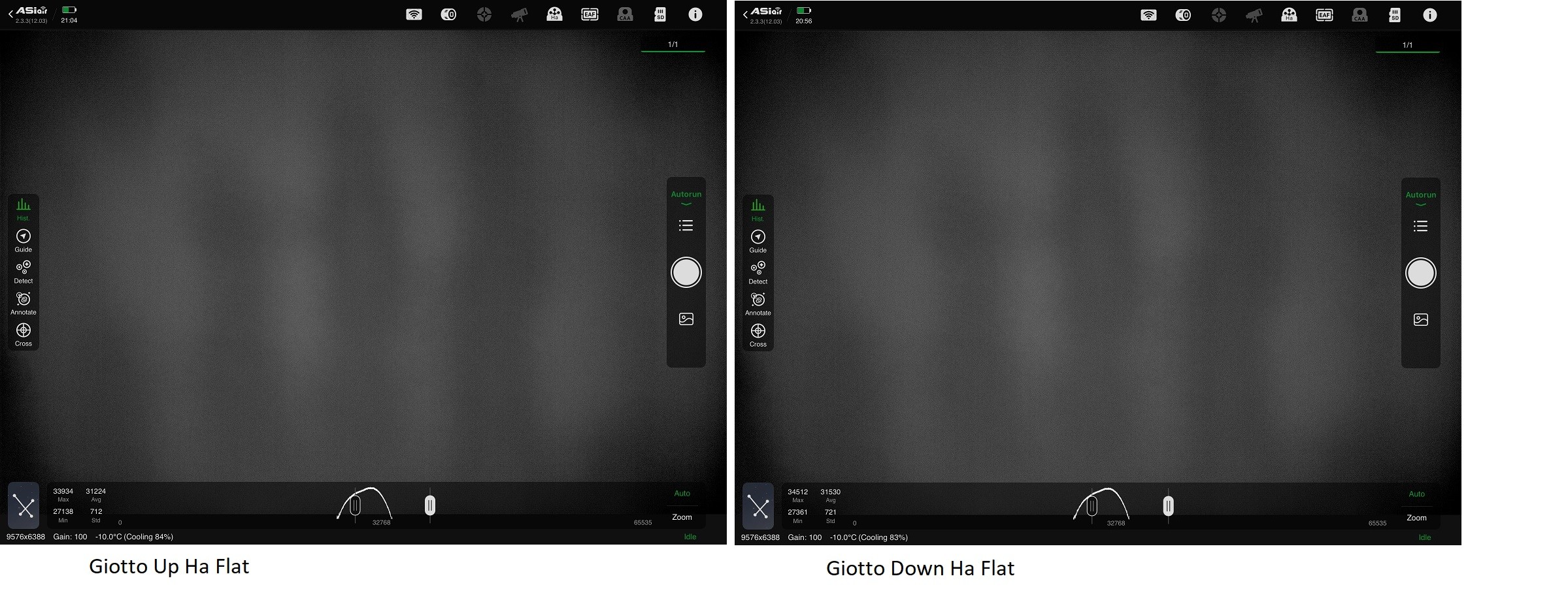

I recently purchased new filters, FW and 6200mm. I do not have light leaks as I have done many tests. I have used a trace panel , Giotto flat field generator and sky flats and still get banding issues with new filters, new filterwheel and new 6200mm. Used gloves and mask to put together so no 'smudges' of any kind. I have even tried different power banks for power, rotated my flat field generator and rotated my captains wheel on my telescope, but banding in my flats is plain to see. It very apparent in Ha and Sii. Its also visible in the other filters with an STF stretch in pixinsisght. I have sent numerous fits and pictures to the shop where I purchased my gear which they are still looking at to try and find a cause. As the gear (apart from the scope) is brand new and bad weather I have only managed to get seven fit files of the Carina Nebula. I have not been able to stack the lights just to see If it effects the final photo outright.

I started a thread on Astrobin to see if I could also get an explanation. Seems as If some else has the same banding using the same camera? https://www.astrobin.com/forum/post/196372/
This is my banding. Same banding using Gain 0 or 100
