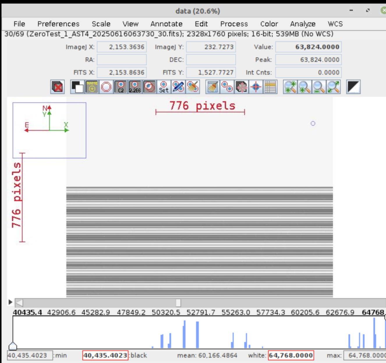

For the imaging camera it seams that the read out is not working properly as also in case of no light we are getting horizontal lines or perpendicular structures on the images (see bellow the figure)

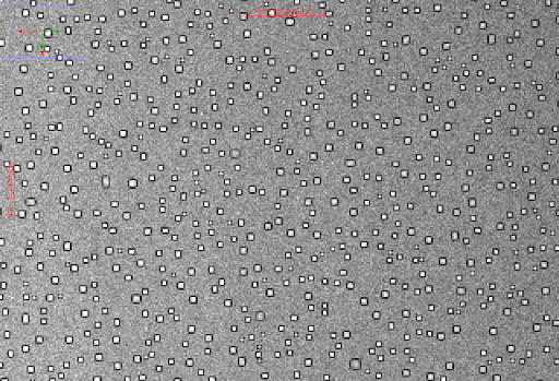

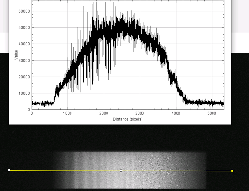

Second (the spectral camera) is showing recording strange very intensive pixels already when iluminated by the calibration lamp for flat acquisitions (see figures bellow).
