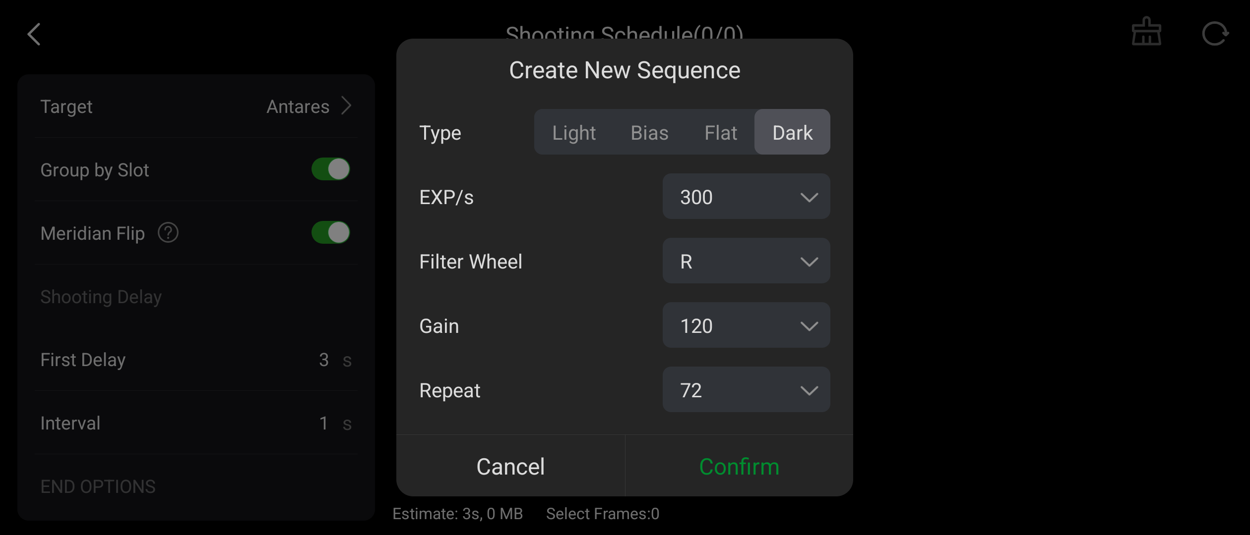

The ASIAIR firmware has been updated to 2.4.12.29. This has caused problems in using the ASI294MMPro.
When using Autorun to set up the camera to take pictures, the entire bin setting has disappeared.
This has caused the binning of the camera to change from the default bin2 to bin1, i.e. 46MP, 4144x2822 to 8288x5644.

However, the next day, the same symptoms appeared again and this time I could not select binning in
Autorun even if I selected bin2 in the Preview screen and took something.
Please tell me how to select binning and how to do it consistently after each launch.
