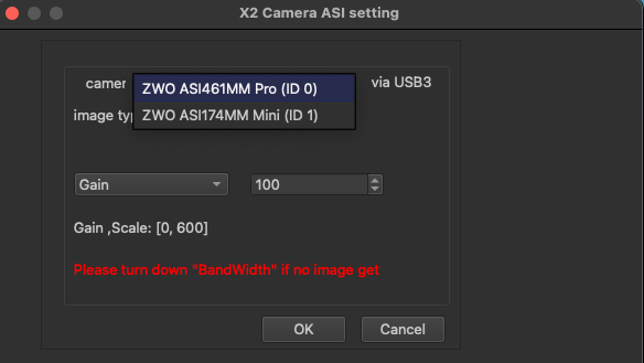

I'm running TheSky on a Mac mini M4 (with the latest macOS). I'm using TheSky version 10.5.0 build 13878, along with TheSkyX_ZWO_ASICamera_V3.37.tar. When I open the camera settings and try to change which camera is selected, TheSky crashes. I have an ASI461MM Pro and an ASI174MM Mini currently connected via a Pegasus Astro UPBv3. I also have an ASI6200MM Pro and a ASI220MM Mini connected to the Pegasus Astro UPBv3 - but the USB powers and power ports are turned off. When I try to change the camera from the settings dialog, TheSky crashes - and the backtrace points to the driver.
