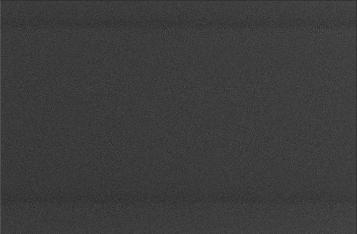

I have a Dark band at the top and bottom of my images and It appears to be fixed and doesn't move around. The bands are at the top and bottom only - and never at the sides or in the middle. It is impacted by exposure time. 10 seconds it is hardly visible but at 60, 120 seconds it is very obvious. The camera ran fine for about a year and then it started doing this.

I have tried to attach images and have been unsuccessful (keeps giving an error). So I am pasting a screenshot of it.
