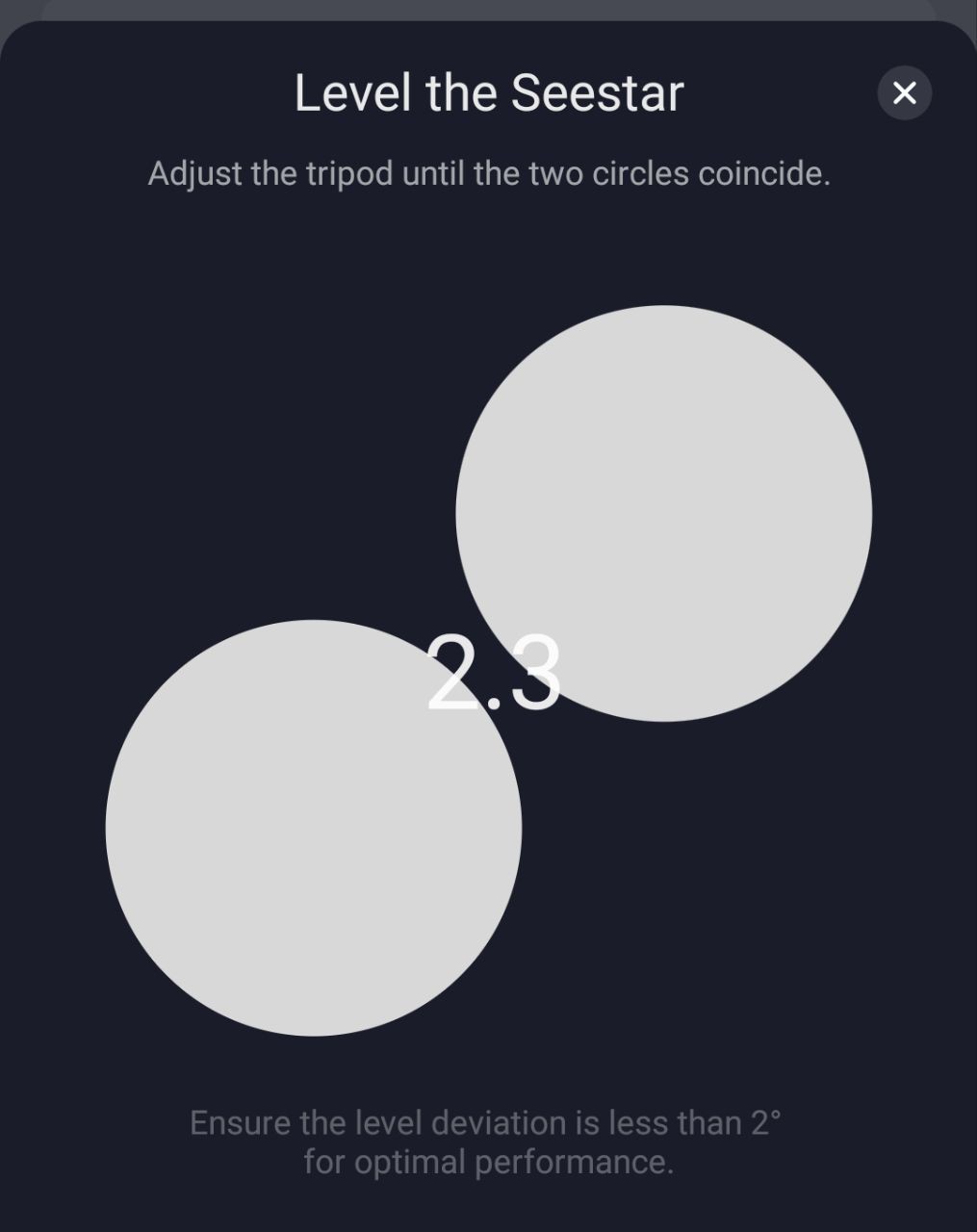

Had issues with polar alignment. App continuously complaining I'm 2° off after completing the procedure and starting alignment again.
And what do you think? Finally got the level surface, error isn't more than 0.1°
And S50 shows
Dear ZWO, what would you say?? Do you calibrate it on your assembling line??
After level sensor calibration the issue has gone. No prob so far.
