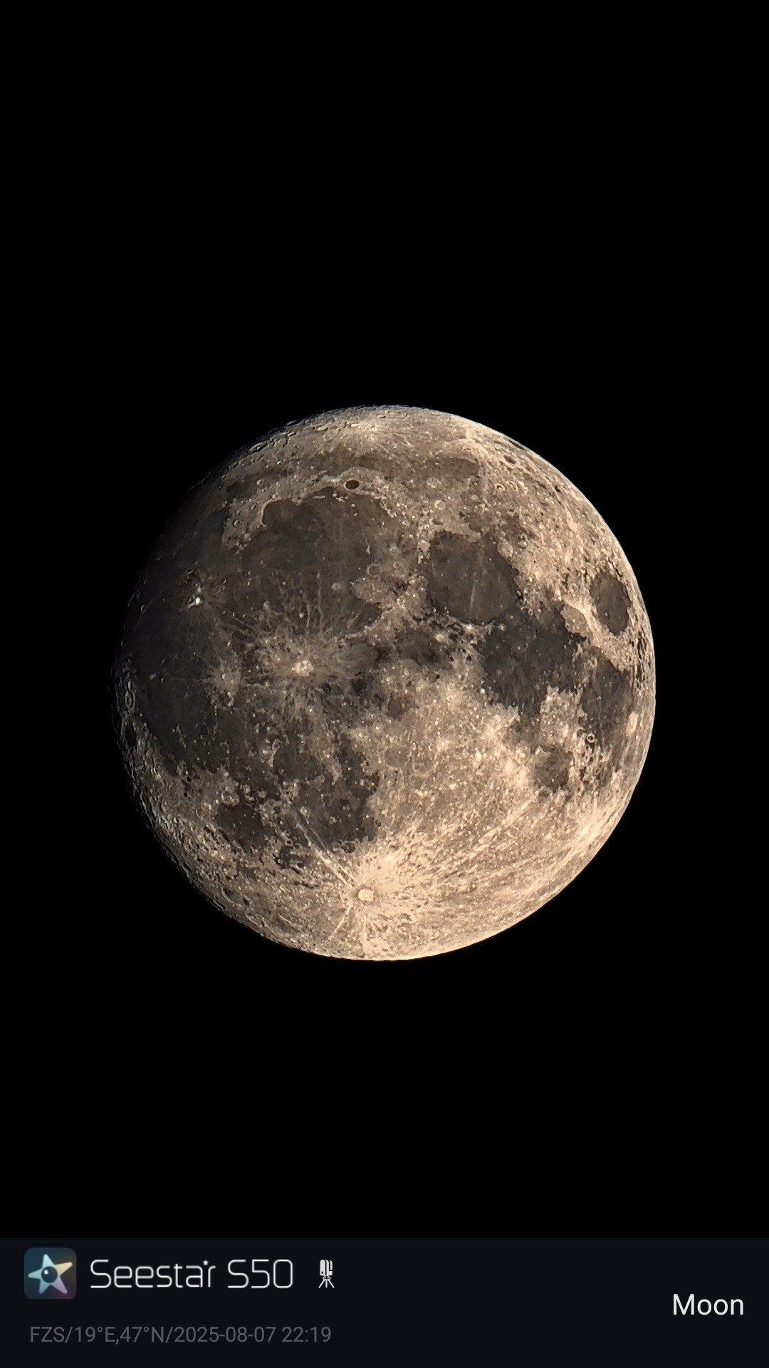

I can also confirm moon images are now different in appearance with the latest firmware/software. They seem to have more contrast and appear darker. Less detail is visible.
Contrast the above image with an older image:-
