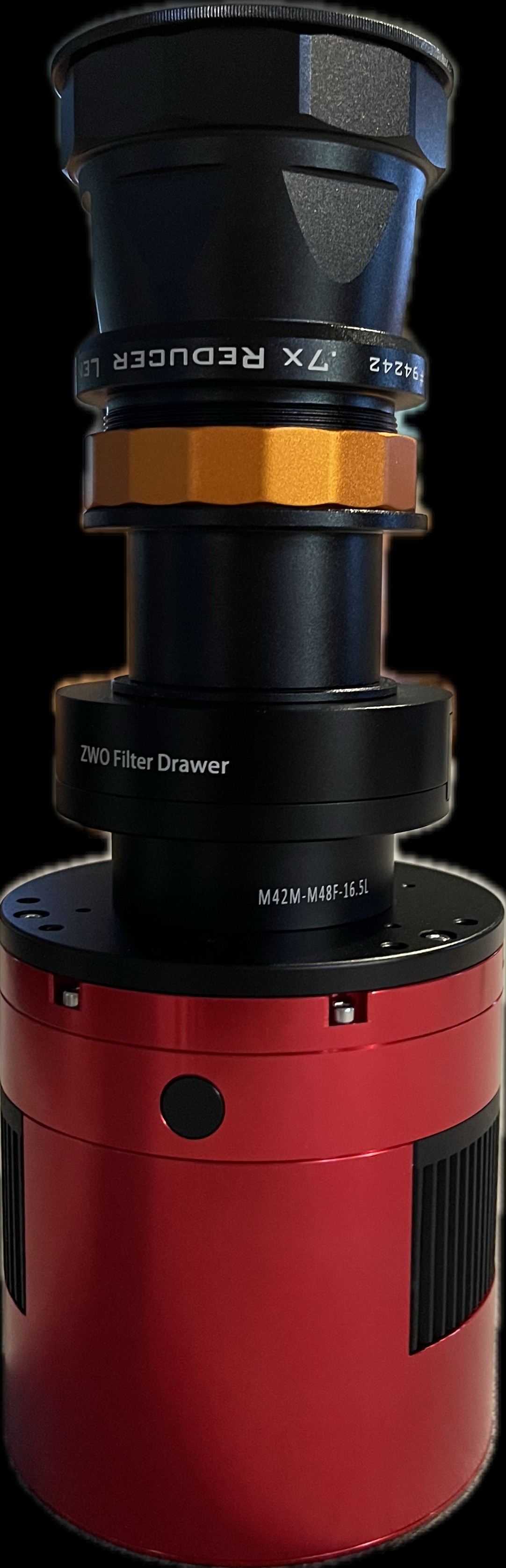

First a little background. I am fairly new to using telescopes, but very familiar to SLR cameras. Over the last three years I have been putting together a telescope set up so that I can do some astrophotography. I have the ZWO 2600mc pro camera attached to my Celestron Edge HD 8 scope with a .7 focal reducer. I have checked the back focus using t adapter and also ZWO filter drawer. Please see picture below.

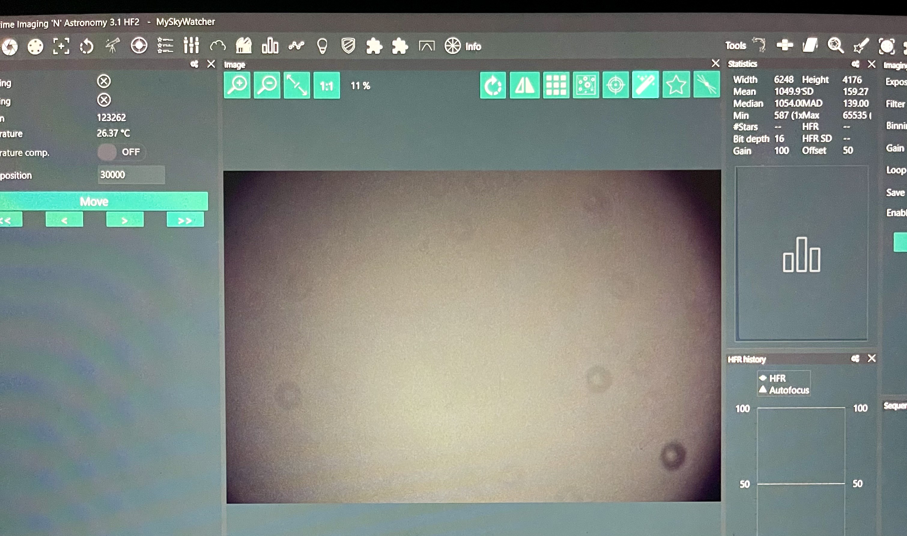

My issue is that I can not get the camera to focus. I have tried using Nina and Sharpcap. I have a zwo mini guide camera that I do not have a problem focusing.
When I try to slew and center to object and focus the screen looks like the picture below. I try to adjust the focus but it does not change. Any idea of what I am doing wrong or if someone is familiar with this behavior and knows how to solve it... Please let me know.
