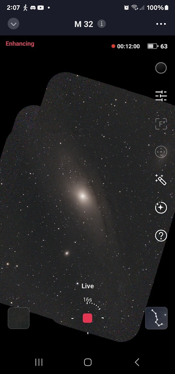

- Mosaic mode did not work at all when first introduced, I was never able to produce a single good image with it, one night was not long enough, and I completely gave up. I am very happy to report that the second version works much better and is actually quite usable. It takes now only 15 minutes of stacking time (which for me translates into 21 minutes of real time) to completely cover an entire 2x frame and then run AI Denoise on it (which refuses to run on an incomplete mosaic image for some reason). I normally do 2 hour exposures which increases the signal to noise ratio but even a 15-minute 2x mosaic AI Denoised looks quite good (that's M52 in the lower left corner):
I did not expect this to work so well now and I am really impressed.
