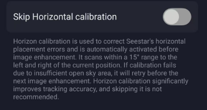

OK, one more comment from me and then I will drop the issue because it seems that I am not getting my point across.
Fundamentally telescopes do not need to be level to be polar aligned. All leveling does is eliminate cross talk between the Az and Alt adjustments. I have forgotten a few times to level my MyT mount when in the field and all that did was make it take a few more back and forth adjustments of both the Alt and Az knobs to get an excellent final PA. Telescopes in Alt-Az mode like the Seestar, Celestron Nexstar line and Skywatcher AZ GTi, for example, direct the user to level the mount but this is only necessary because the software assumes that the mount is level when it solves for a GoTo model. In the case of the Seestar, it has the advantage of having an internal accelerometer and an internal compass which the Celestron and SW do not. So the Celestron and SW need to be set up in a configuration called "Level North" which means the optical tube is both level and pointing north. Otherwise these mounts would be lost. But the Seestar has both internal sensors and could use the data from both (so long as it is accurate enough) to avoid making the user level the mount and point the telescope to north. Apparently the ZWO software engineer decided to use the data from the compass but not the accelerometer to create the first pass pointing model (which is refined by plate solving, i.e. Horizontal Calibration). I see only one reason for not writing the code to use the data from the accelerometer to compensate for whatever angle the Seestar is relative to the local horizon and that would be if the accelerometer is not accurate enough for this. But then it apparently is accurate enough to tell us when the Seestar is level, so there you go.
I suggest you ask the software folks about this and maybe they will get it and then you can have a code update that makes the Seestar even more user friendly.
Thanks for listening.
