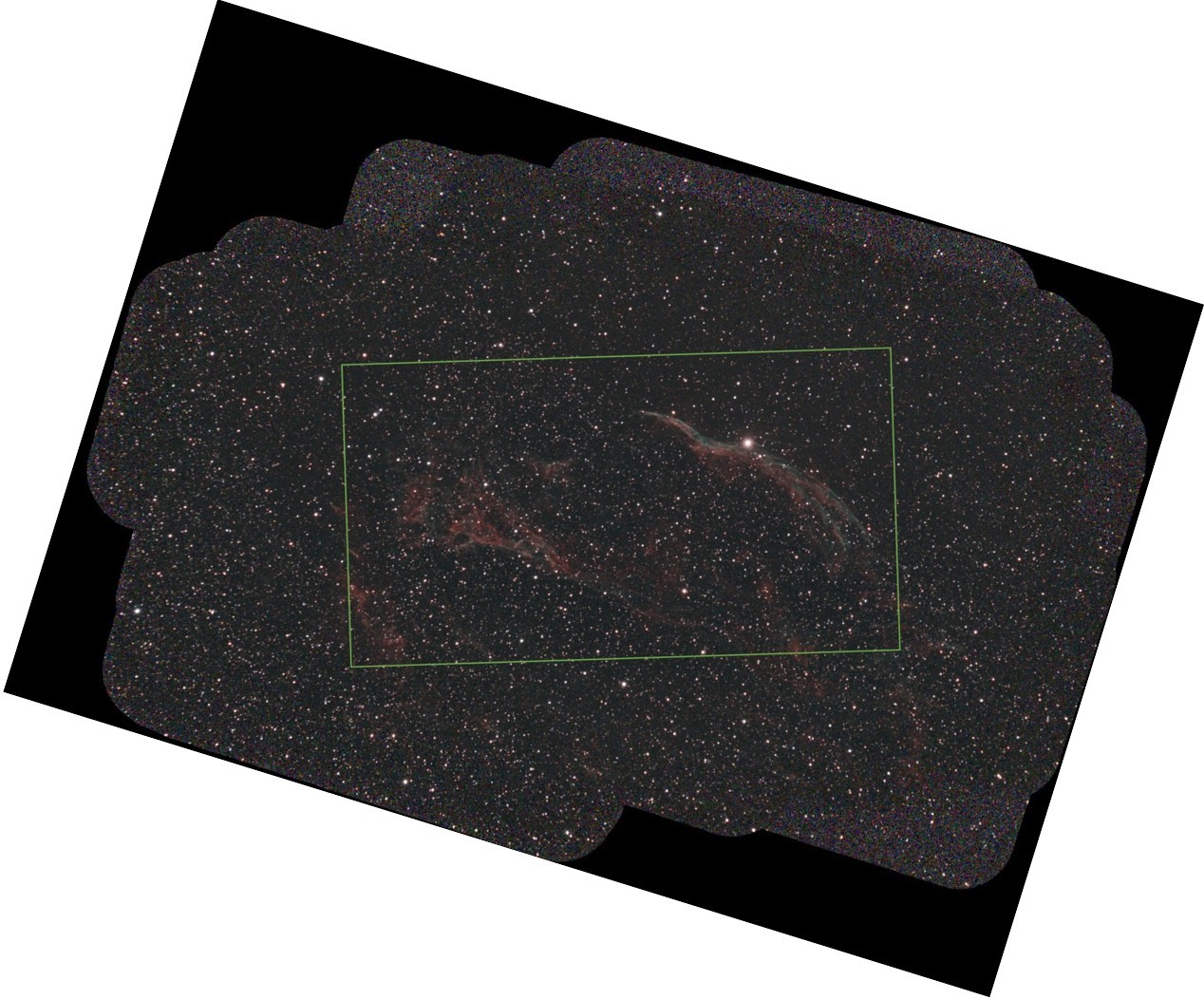

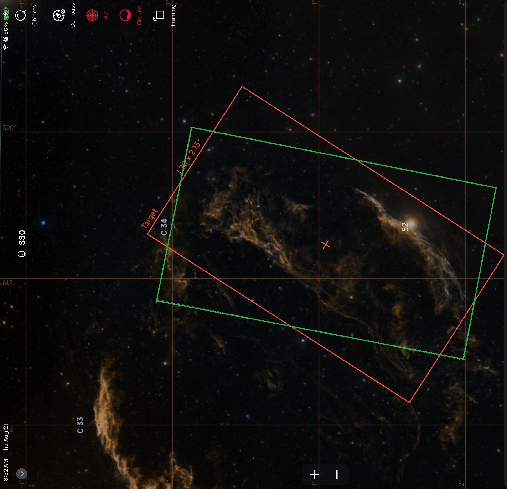

I love mosaic mode and enjoy using it very much. However, I feel that in mosaic mode, the area covered is much larger than I expected. As you can see from my recent capture, the first image is a screenshot of the S30 planning screen. I kept the area coverage set to 1X and only tilted slightly. The orange rectangle shows the native area, and the green rectangle shows my intended framing. However, the final area covered in mosaic mode is at least double what I planned.
I understand that the sensor is fixed and can’t adjust its orientation. But on the software side, is it possible to ensure that each frame does not extend so far outside the intended framing?
