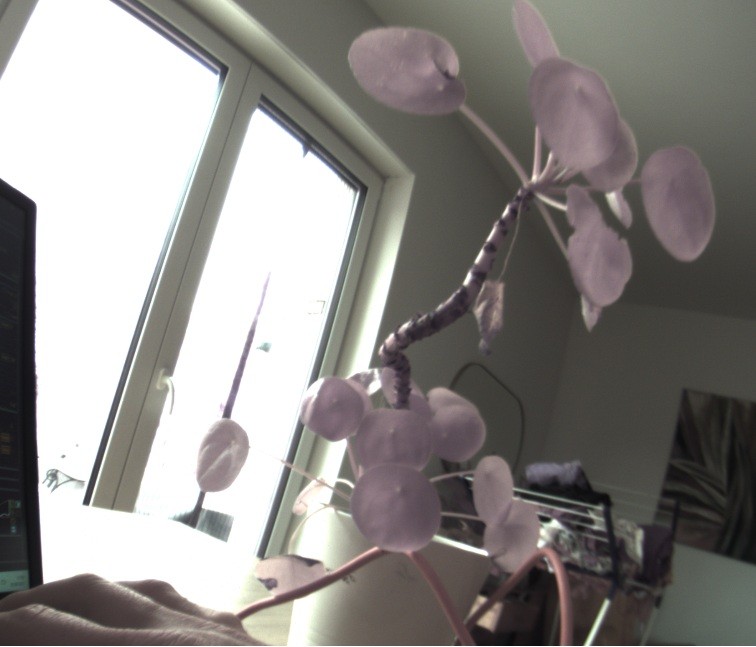

Hi, is it normal that i have no natural colours in my new asi 715 mc - instead of green everything is violet / purple?
Since this camera is a planetary camera, it has relatively high infrared efficiency. Under normal circumstances, it can be used to shoot planets without an infrared cut filter. If you need to shoot landscapes, you can try either of the following methods to ensure normal color reproduction: Replace the lens and add an infrared filter; Replace the camera sensor’s protective glass with the D21IR-CUT model (purchase link: https://www.zwoastro.com/product/zwo-protective-window-for-asi-cameras/).
