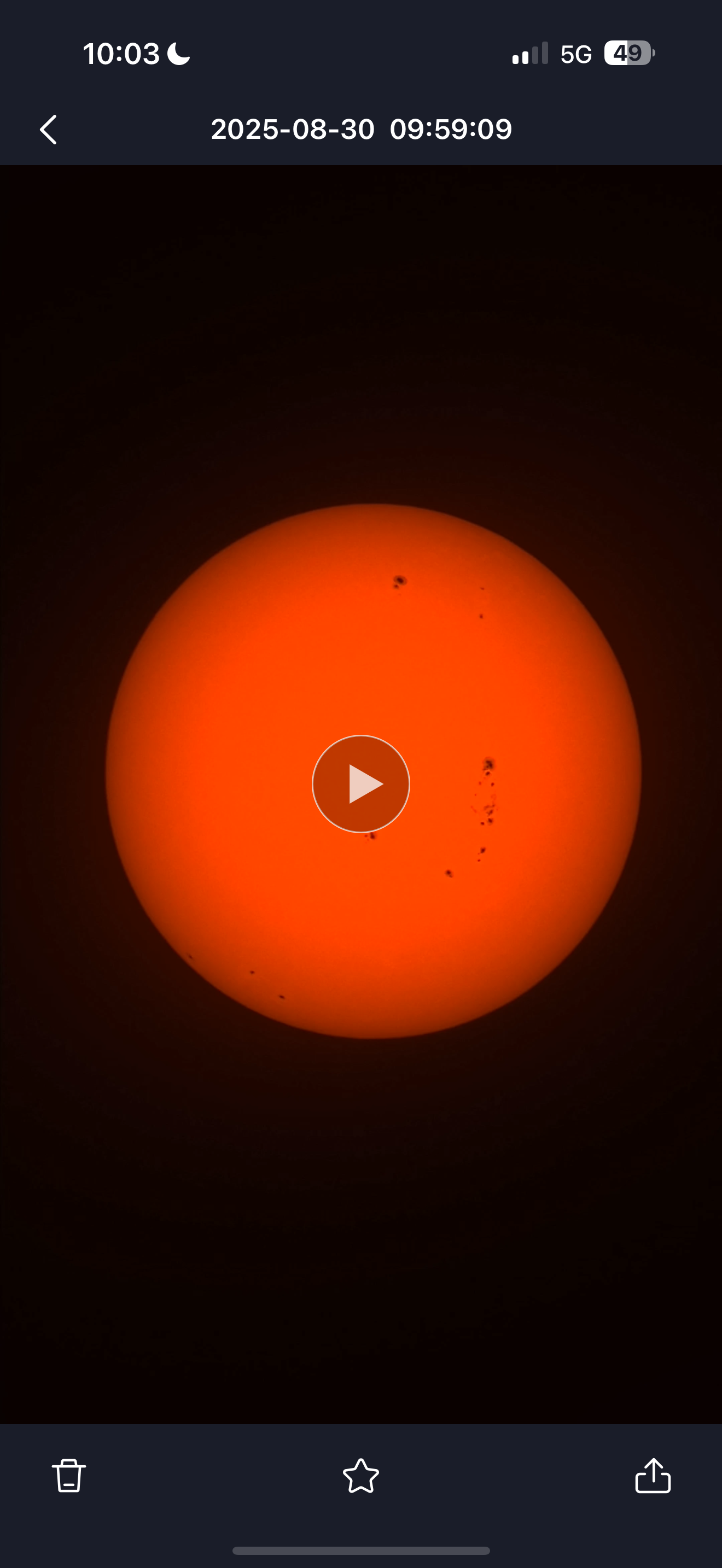

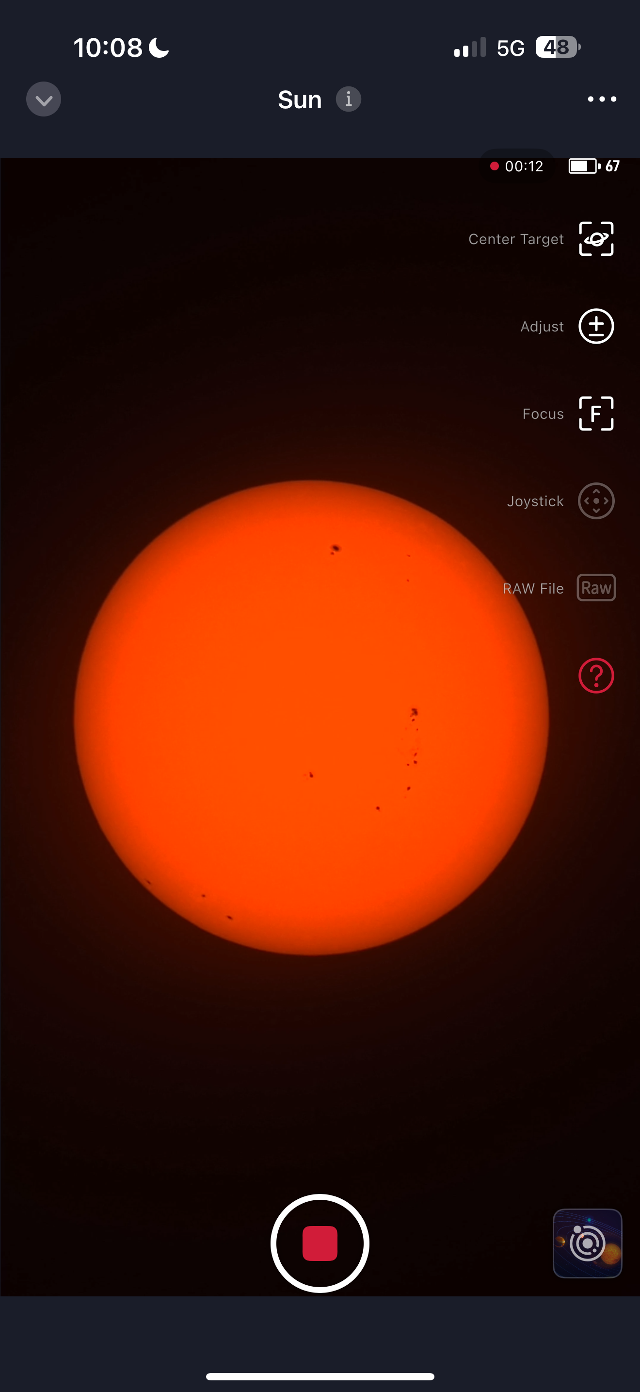

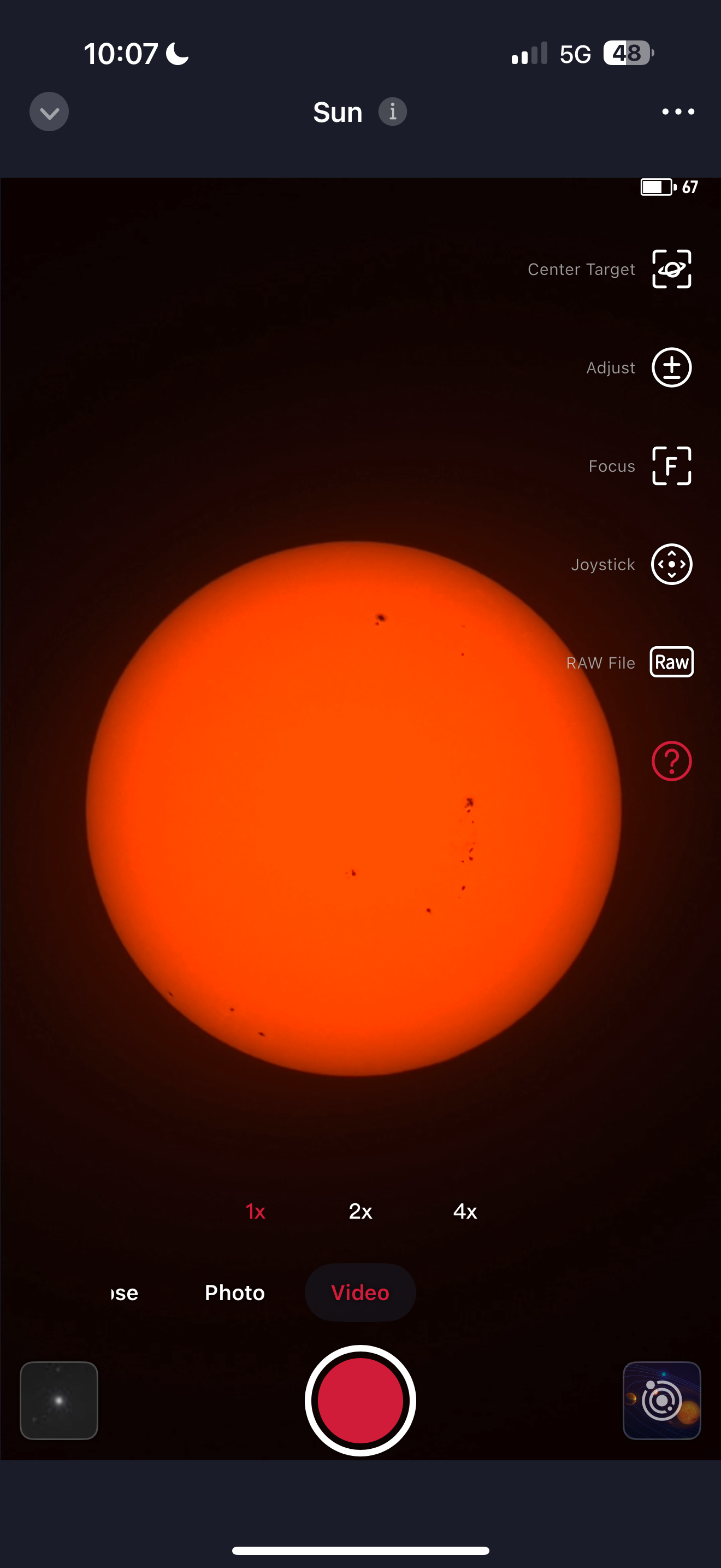

The staking option does not appear when a sun video stored into the Seestar is being played. Before taking a sun video, I make sure the RAW option is on, but after starting the capture, the RAW option goes off.

You can see from your photos that RAW is not used. If you have turned on the RAW option, RAW will be displayed in red unless you change the shooting mode after clicking RAW.
