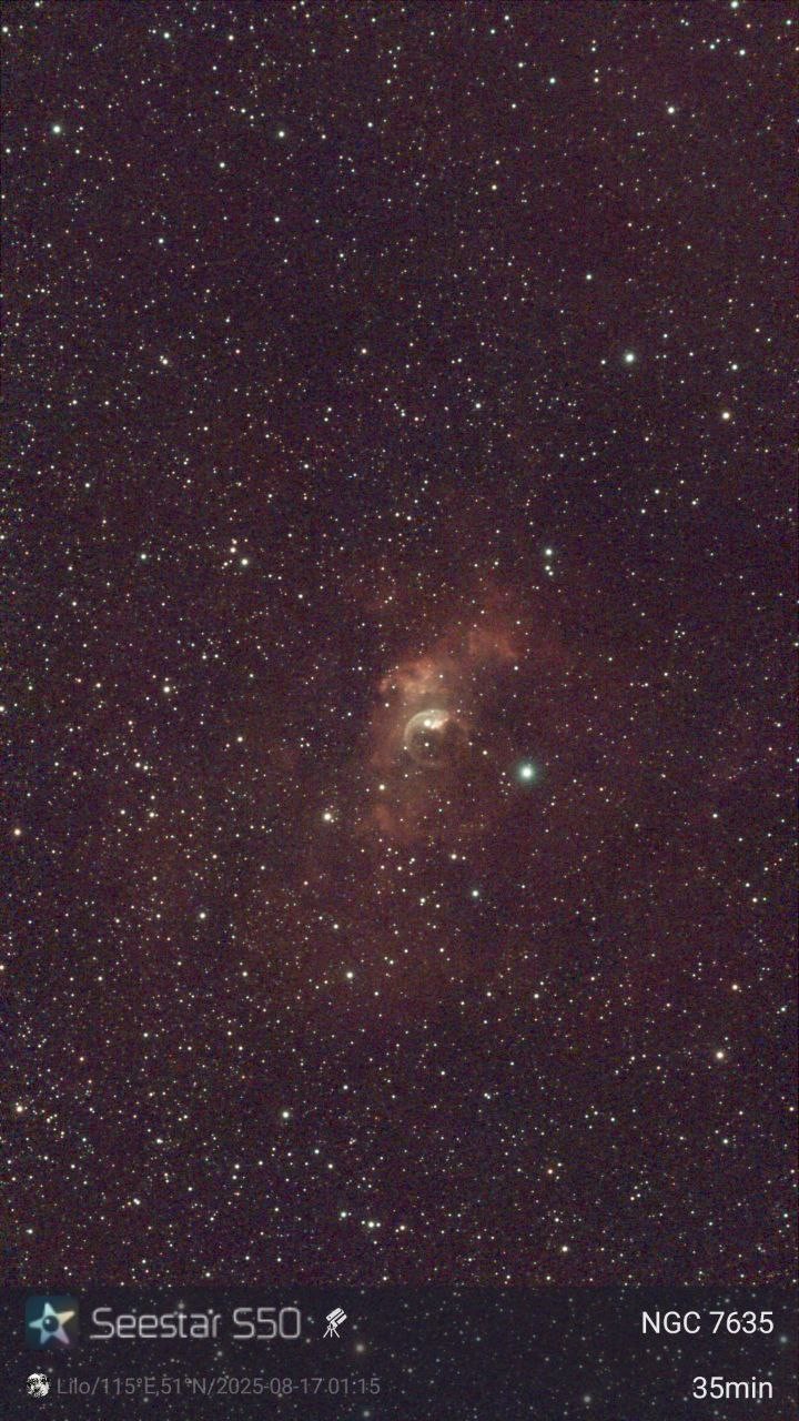

I woke up to this last night…never seen this before. Individual subs are fine. Ai denoise removes the colour also.

Support@Seestar I have sent the FIT image through the bug report. Thank you. I have restacked subs in Pixinsight and they are fine. So the issue seems to be with the live stacking. Bug report submitted

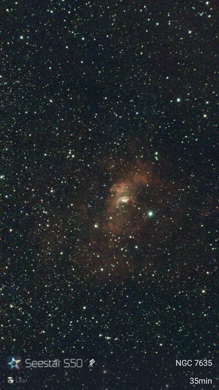

Had a similar issue recently. Live stack fell to reddish after some time, though at the beginning of the session everything looked Ok. Individual subs are Ok and stacking in DeepSkyStack afterwards produced a good result.
