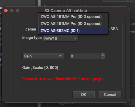

If I start with only the ASI461 and ASI662 plugged in, and open TheSkyX, and go to the ZWO camera settings, I have a choice of the two cameras: ASI461 and ASI662. I select the ASI461 and I'm able to connect to the ASI461 and take a photo.

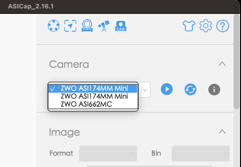

I then plug in the ASI174 to USB. In TheSkyX ZWO camera settings, it now shows three cameras "ASI461, ASI461 and ASI662". If I keep TheSkyX running and also open ASIStudio/ASIImg, it lists "ASI174, ASI174, ASI662". I can connect to the ASI174 and capture images. I can also switch back to TheSkyX (leaving ASIImg running) and capture images from the ASI461.
