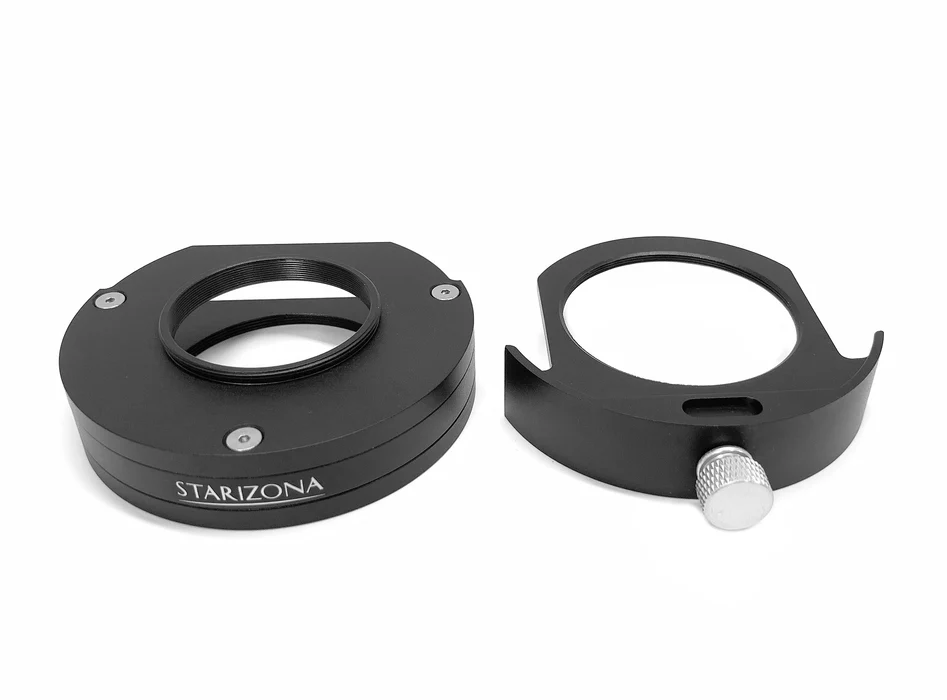

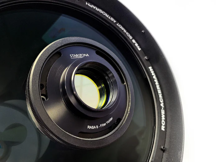

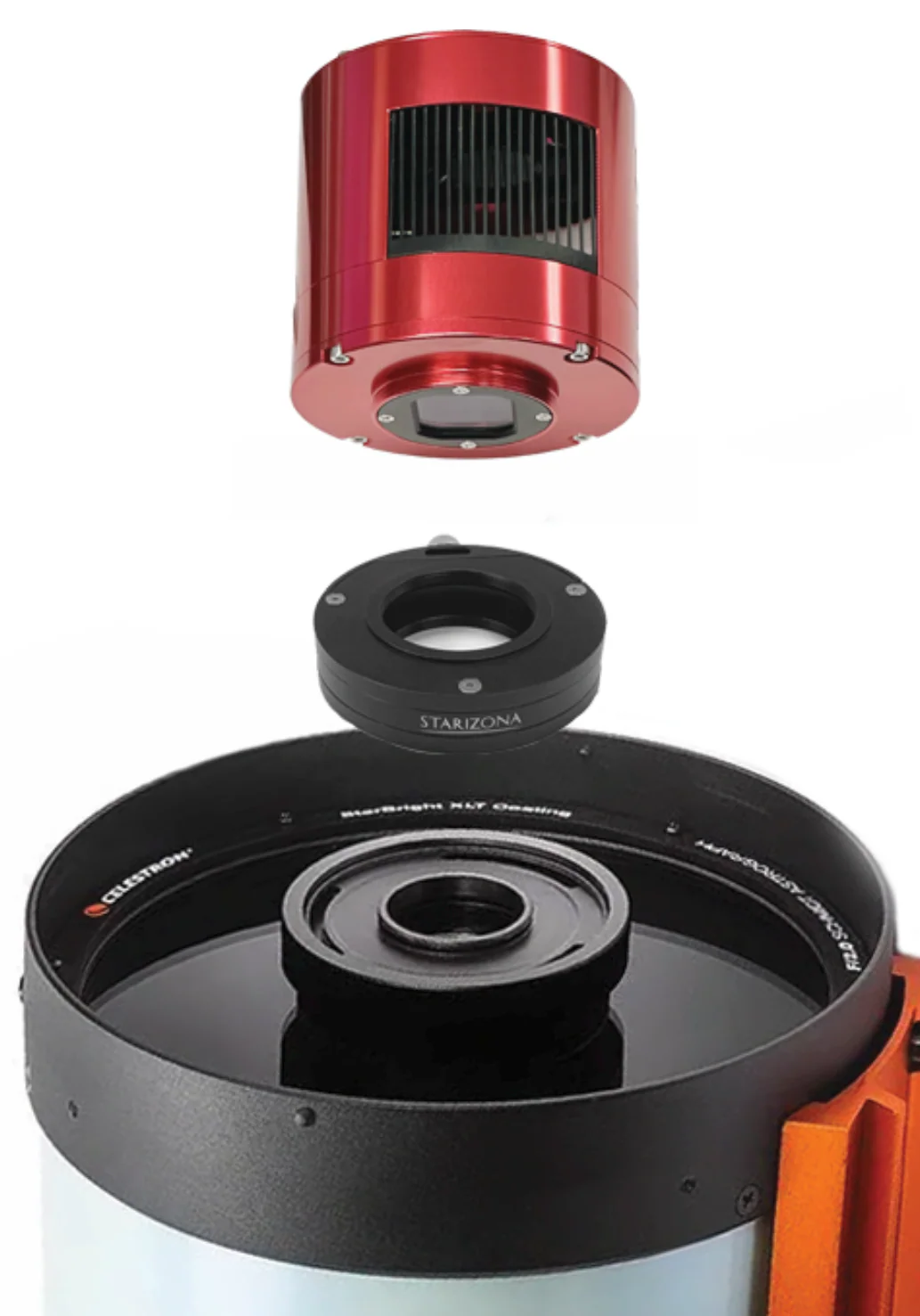

I use this Starizona filter slider on the Celestron RASA 8 with the ASI 183:
The Celestron RASA has a backfocus of 25mm.
The ASI 183 has a backfocus of 6.5mm, and the Starizona filter has a thickness of 18.5mm, which allows me to reach the optimal backfocus, with the advantage of being able to use a filter drawer.
I cannot use a filter wheel on the RASA because of the front obstruction.

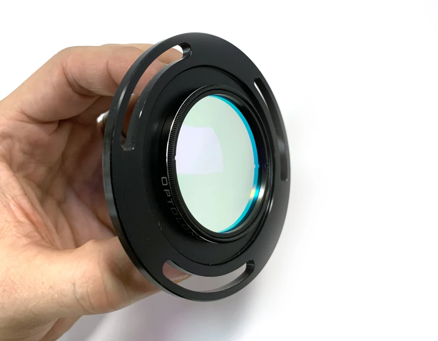

The ASI 585AIR has a backfocus of 17.5mm, which makes it impossible to use the filter drawer, so I would have to fall back on a “fixed” filter system like this one:
This basically makes it impossible to switch filters quickly during imaging sessions.
