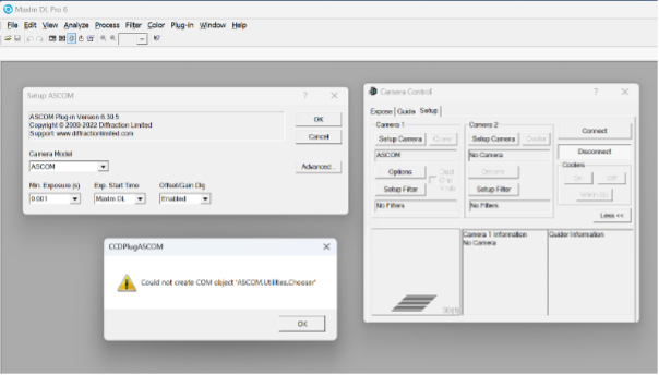

On the first one I get a "Could not create COM object 'ASCOM.Utilities.Chooser'" error as in the screenshot below.

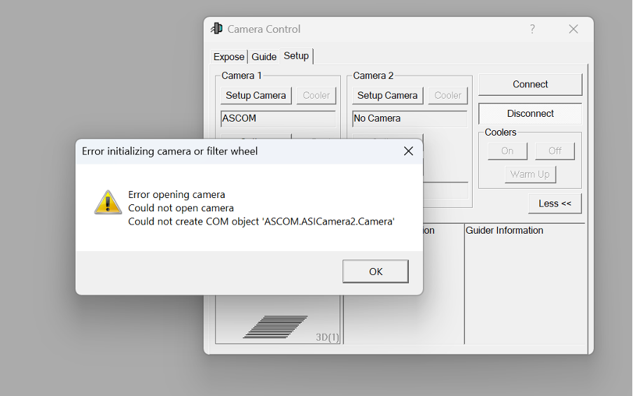

If I continue anyway and try and connect I get the following error:

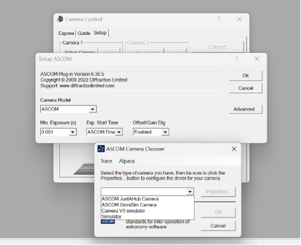

On the second laptop I get as far as the ASCOM Camera Chooser coming up but the options do not contain the ASI Camera (1) option that I believe I should be choosing as the main camera. The only options I get are things like ASCOM JustAHub Camera as in the screenshot below:
Note it doesn't matter whether I chose MaxImDL or ASCOM Driver in the Exp Start Time box I get the same choices.
