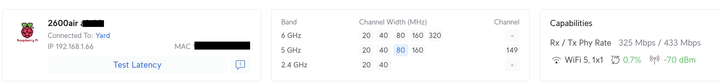

To demonstrate, my ASI2600MC camera is connected using a quality 12V 6amp power supply, with a 5Ghz AP literally 12 ft away and this is the connection on the camera:
From that distance you would expect much more than -70dBm, and I think that this is impacting my download speeds.
