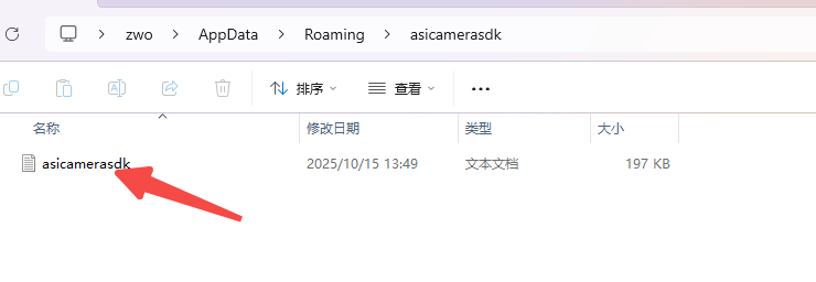

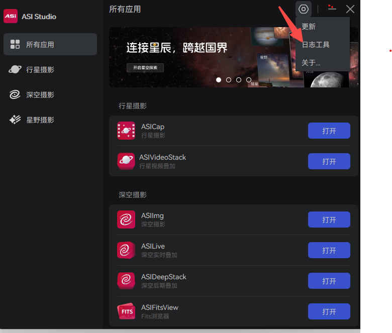

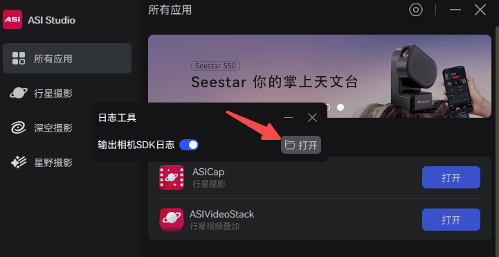

Open your camera log. Then, if this situation occurs again the next time you use (the camera), send the log to my email address. We can communicate via email, which will be more convenient. The email address is: Joye.Zheng@zwoastro.com
