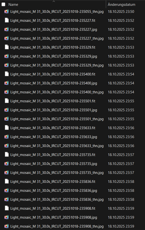

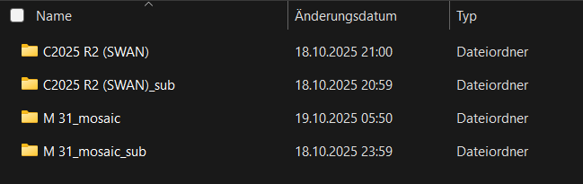

Last night, I used a plan for a mosaic, from 21:10 to 6:00. From 21:10 to 23:59 a total of 136 subs were saved. That's a rate of 40% - which isn't great, but OK.

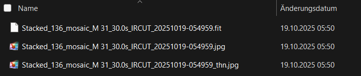

From 00:00 on, not a single sub is saved. The stacked image also has 136 in the filename. But it was saved at 5:50 (according to file name and timestamp of the file). That means, the process itself continued until almost 6:00 - but suddenly no images were taken any more.

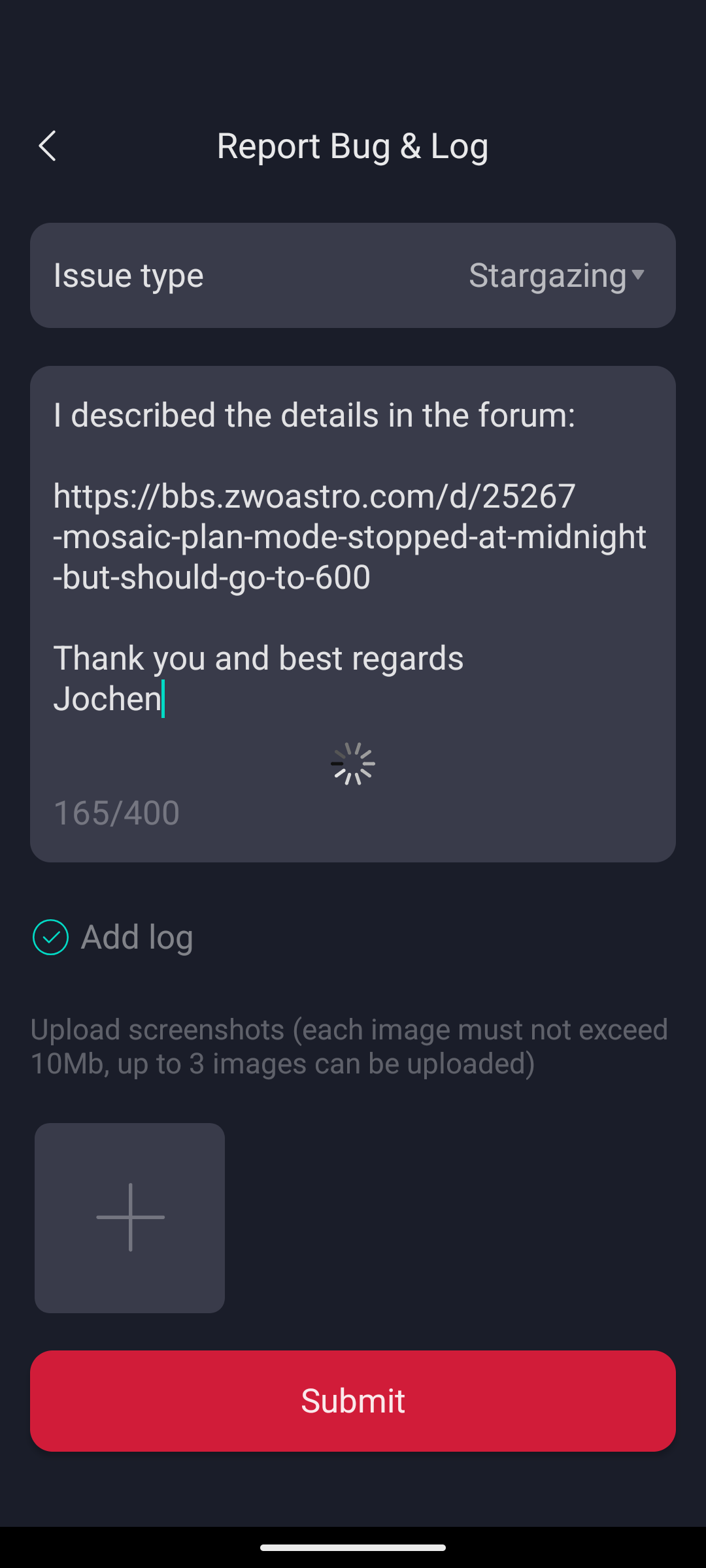

Did anyone experience the same? Might there be some bug? Or might there be a mistake from my side I'm not aware of?
Thank you for your help!
