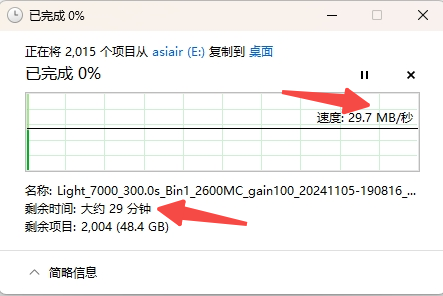

Thank you for conducting the test. It seems based on your results that the USB-C port is limited to USB 2.0 speeds, not the USB 3.0+ speeds typical when using USB-C ports.  (USB 2.0 is approx 30 MB/s)
These are the same speeds my camera is getting.
