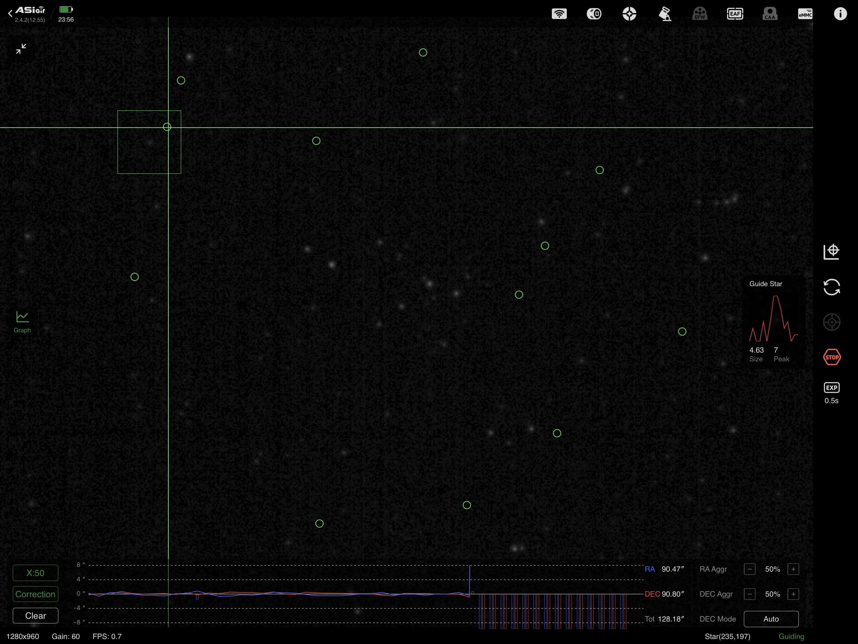

After the 2 recent asiair firmware updates, I have been having issues with guiding. It says star lost.
Whenever I slew to a target after calibration, it can't seem to find the right stars. It keeps on locking to very faint stars. It seems that the HFD code is locked to a smaller value.
I have to manually stop looping, reloop, tap multi-star then it will select the brighter stars.
I have tried all possible settings, different gain and exposure but never had any luck. I even refocused the guide scope. I have never had this problem until the 2 most recent asiair updates.
I am convinced that it's a software issue. If anyone had similar issue and was able to fix it, please let me know. Thanks!
