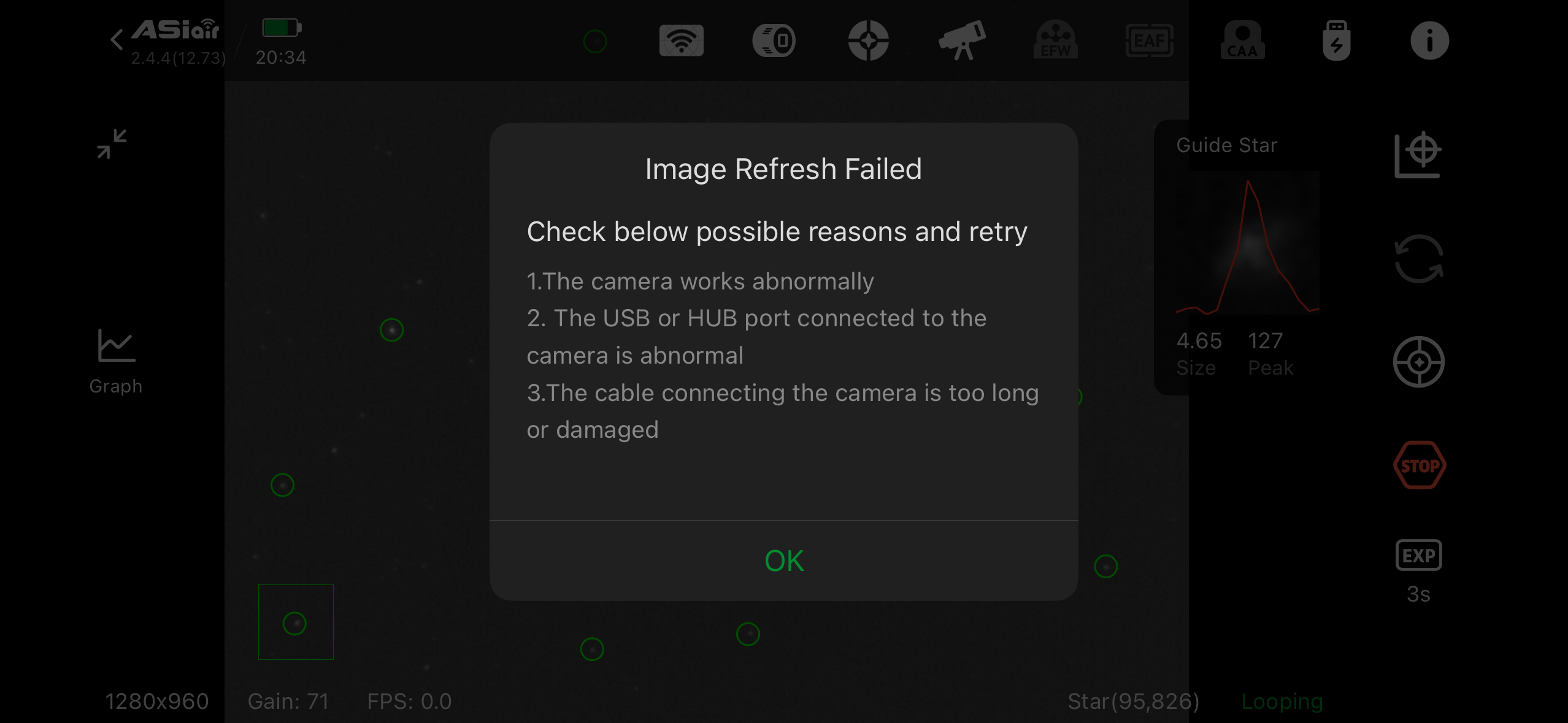

The first night, the guide camera disconnected and gave the error message in the image below.
I assumed a bad USB cable so I swapped it out with a new one which I had.
Seemed to work ok for the rest of the night.
The 2nd night the same problems happened again but this time I noticed that the cooling had stopped on the camera at the same time as the guide camera disconnected. So I swapped out the power supply to a brand new ZWO 12V 5A one and connected the camera to the ASIAIR power port instead of it's own supply.
That worked for the rest of that night.
However here we are again tonight and these disconnections have happened 3 times already. Guide camera and cooling. Only switching off and on power to the camera in the app allowed them to reconnect.
