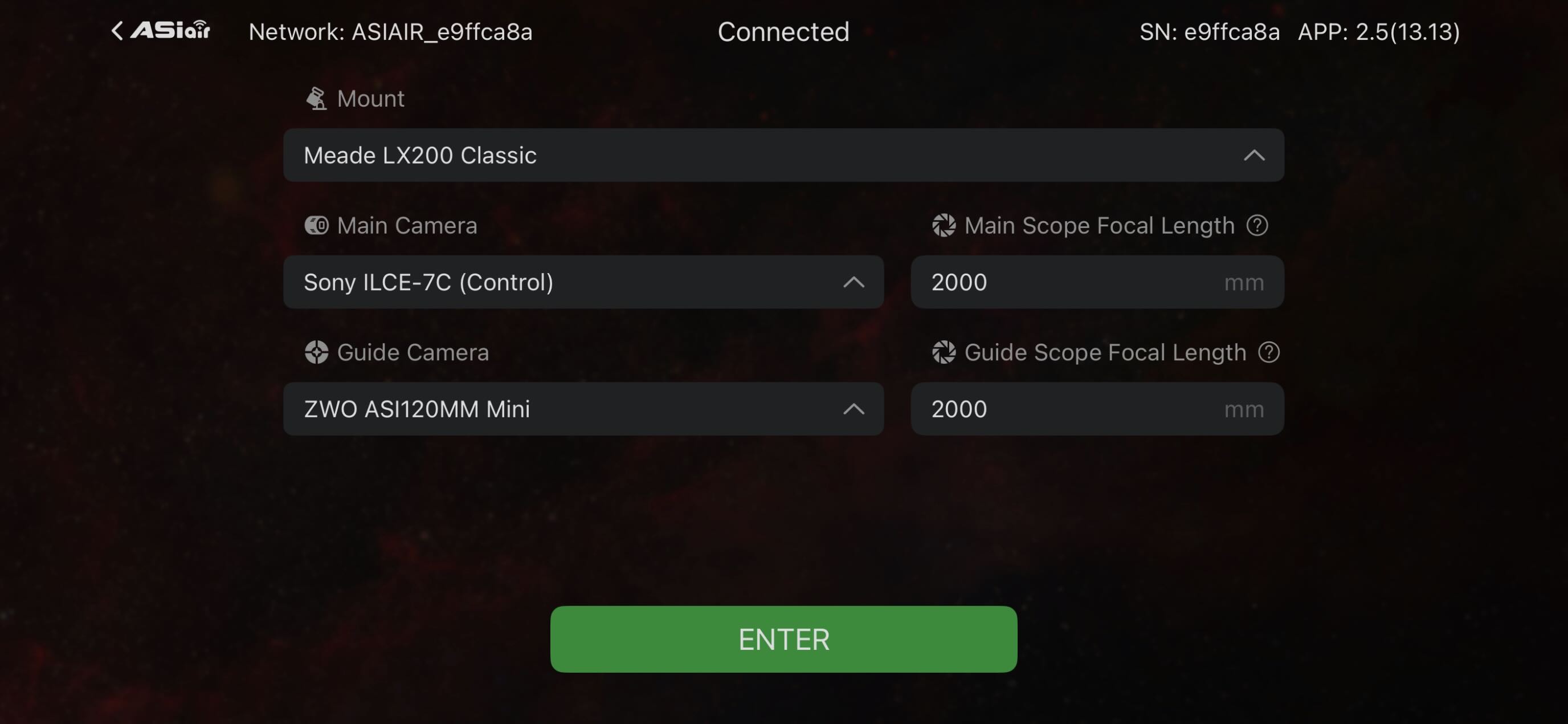

EQUIPMENT CONFIGURATION
• ASIAIR Mini v2.5 (13.13) - Serial Number: e9ffca8a
• Mount: Meade LX200R 8" (GPS SMT v4.0g)
• Driver: "Meade LX200 Classic"
• Connection: USB-Serial (CP2102 chip)
• Main Camera: Sony ILCE-7C
• Guide Camera: ZWO ASI120MM Mini
• Device: iPhone 16 Pro Max + iOS 26.1

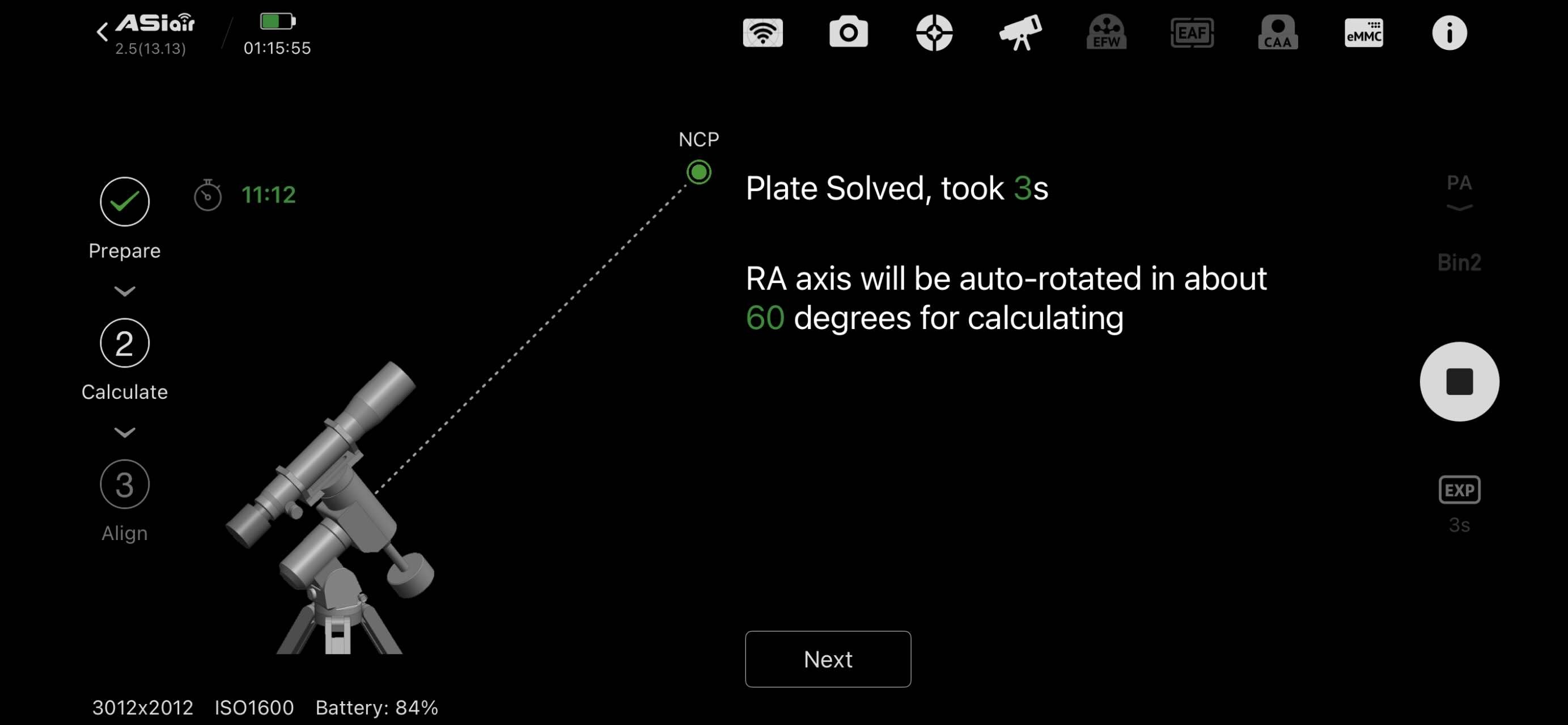

Issue 1: All-Sky Polar Alignment - Infinite Loop
- Plate solving succeeds
- "RA axis will be auto-rotated..." screen appears
- Pressing "Next" causes infinite loop
- Mount rotates 180+ degrees without completing
- Tested with 2 different cables → Same behavior
Issue 2: STOP Command Complete Failure
- STOP button completely ignored
- Mount continues slewing indefinitely
- Only solution: Physical power switch (safety hazard!)
- Started AFTER the polar alignment issue

I have screenshots available:
- Firmware v2.5(13.13) version
- Equipment configuration (LX200 Classic driver)
- Polar alignment infinite loop screen
