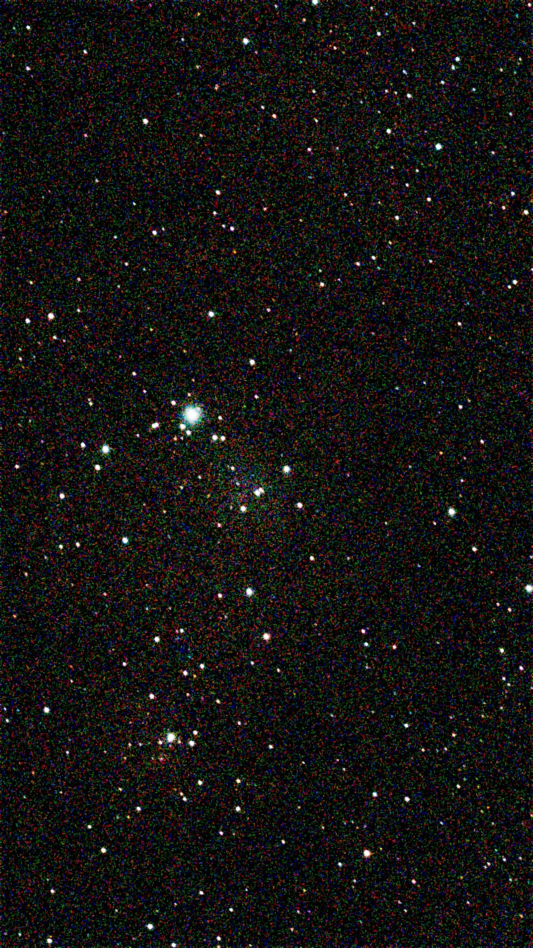

After the update I noticed how my subframes captured with the Seestar changed and showed a very noisy pattern, see left for before and right image for after the update:
I tried to integrate these files with PixInsight but it already stalled/failed on the Debayer step with the error message:
No valid PSF signal samplex on channel ...

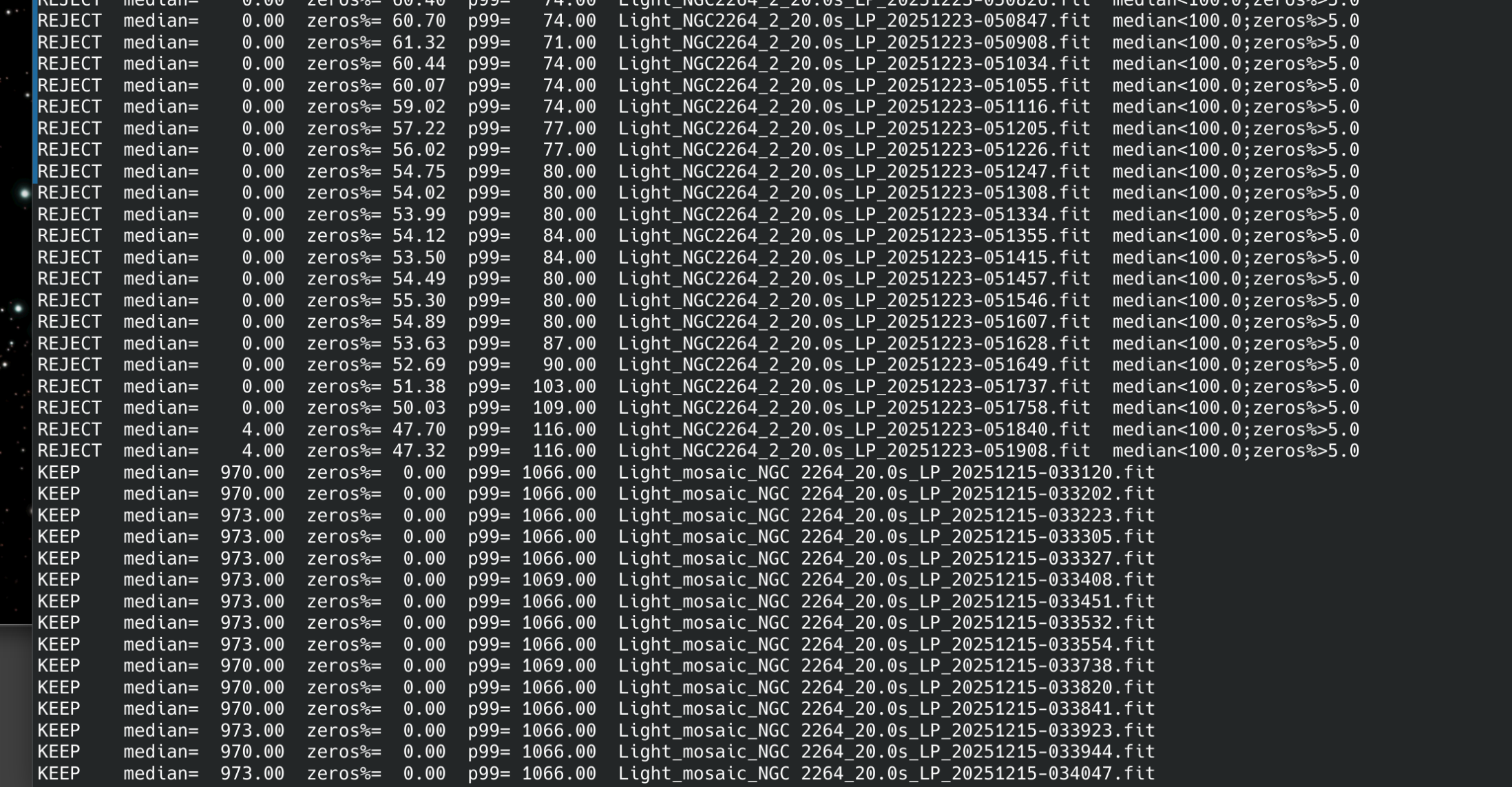

Also the Subframeselector could not load multiple subs at once so I made a script to meassure them with astropy to confirm my hypothesis that somehow the calibration on these files was off - not that I let it print Reject on corupt files:
Post-update frame has 55% of all pixels pinned to the minimum value (0 after BZERO/BSCALE scaling). Given BZERO=32768, this corresponds to raw stored values saturating at the minimum possible signed 16-bit value (−32768) at extremely high frequency, which is consistent with excessive pedestal subtraction / black-level miscalibration / clipping introduced by firmware.
This kind of clipping systematically destroys faint stellar signal and PSF sampling, explaining why PixInsight cannot generate valid PSF signal samples during debayer/PSF detection.
