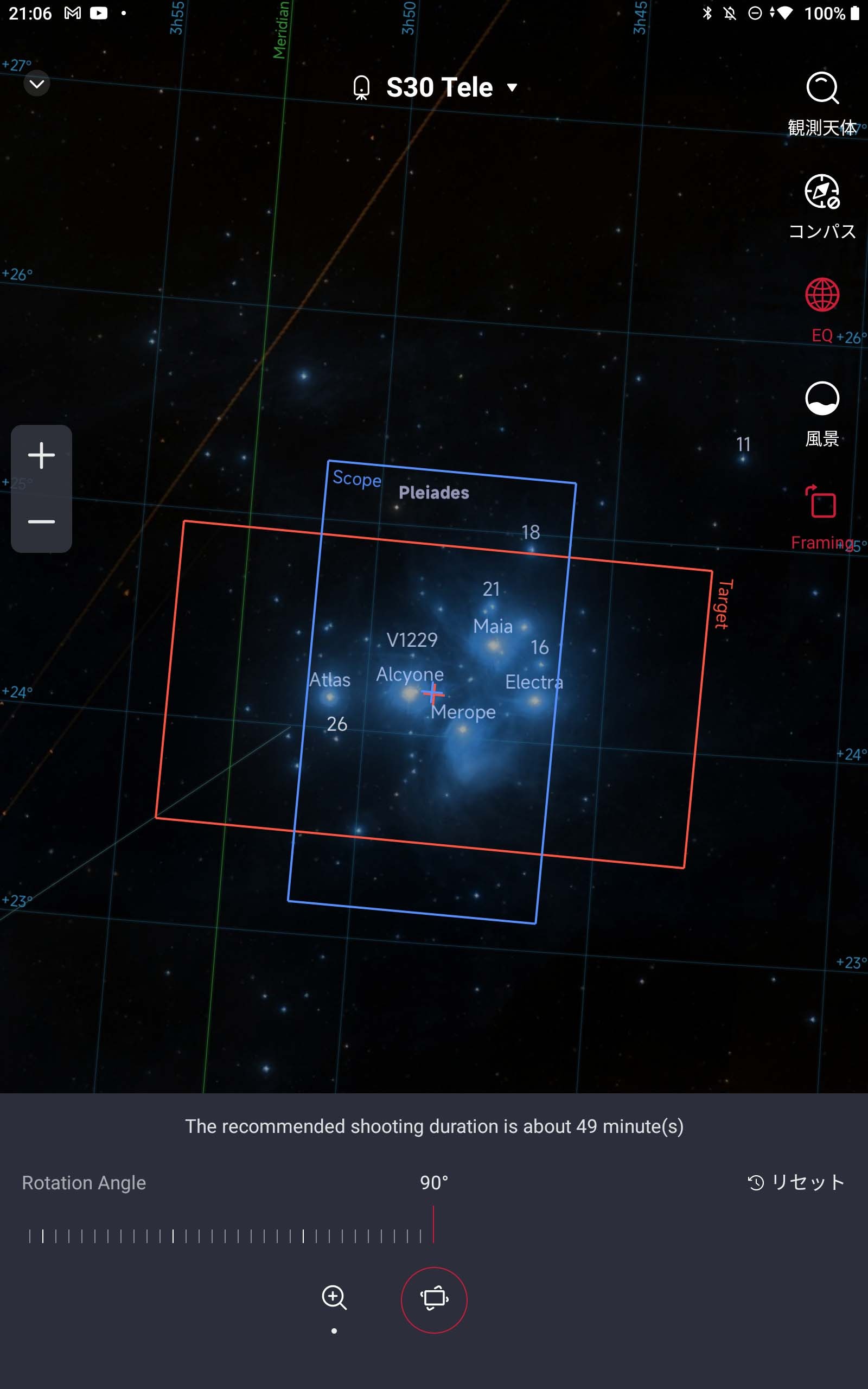

When using EQ-Mode + Framing and starting shooting at 150% size and 90-degree rotation, the SkyAtlas displays the Target (red frame) rotated 90 degrees, and the Scope (blue frame) is oriented with north at the top, as expected.
This works correctly until 5 frames have been captured.

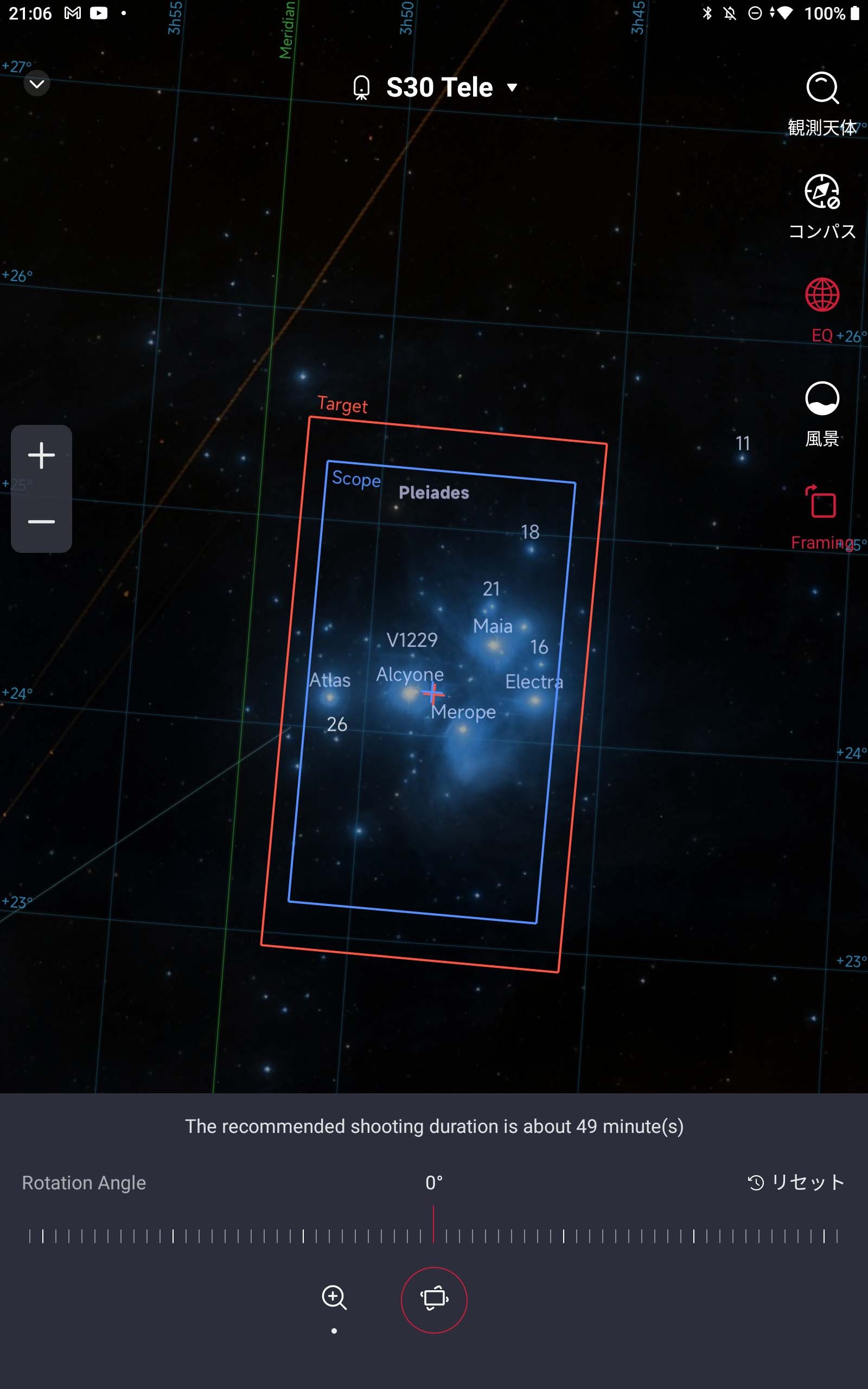

In the 6th frame, Framing moves to the next shooting position.

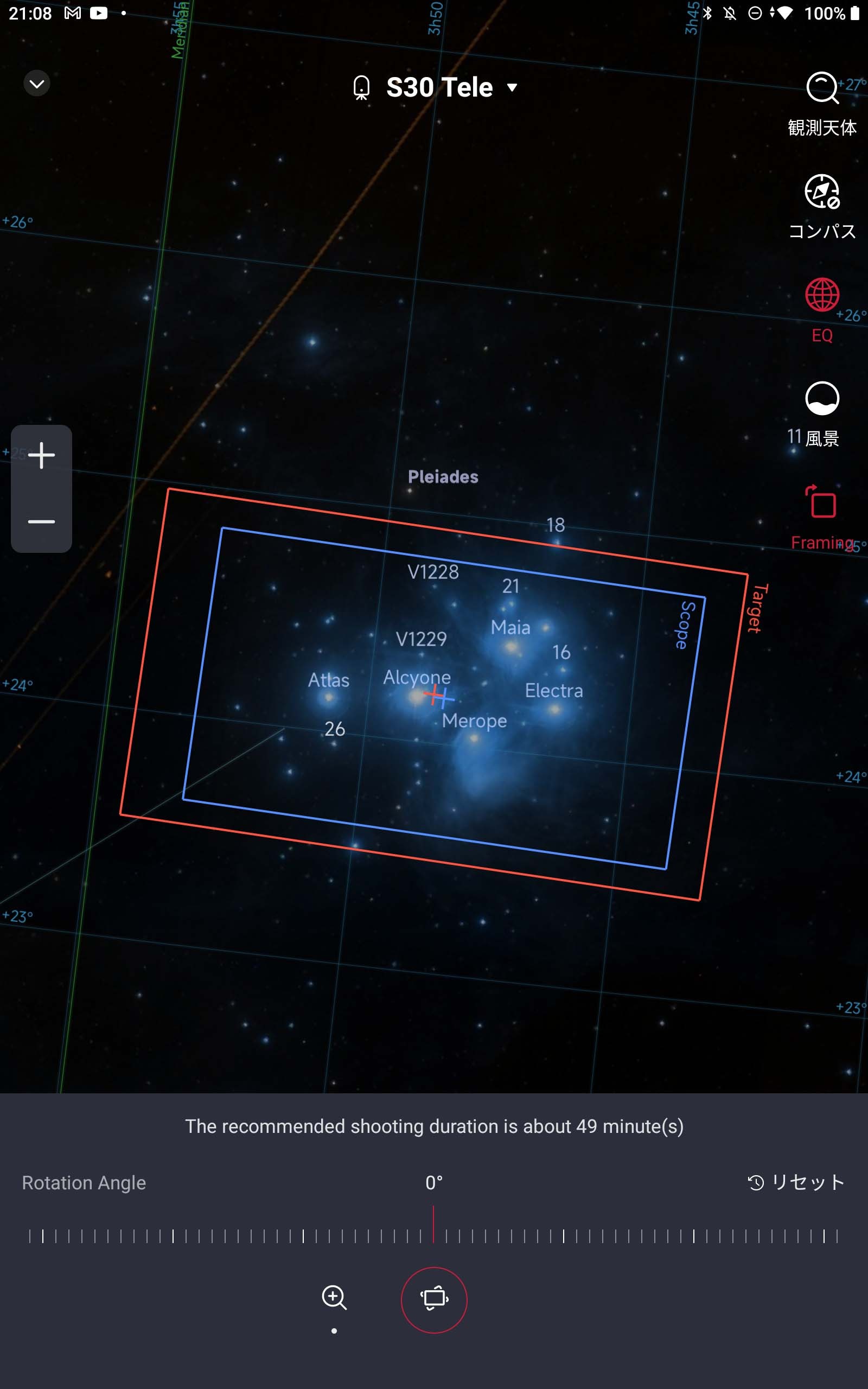

At this point, the Scope (red frame) on the SkyAtlas rotates 90 degrees, changing its orientation to match that of the Target (gray frame).
Since the Scope should not rotate in EQ-Mode, this is a bug.
From this point onward, the system will capture images at the center of the field of view, assuming the Scope is rotated 90 degrees.
However, since the Scope is actually rotated 0 degrees, it cannot capture the entire edge of the Target.
The Scope's orientation will remain rotated 90 degrees even when it moves to the next celestial object.
Specifying a -90 degree rotation again in Framing will return it to 0 degrees.
