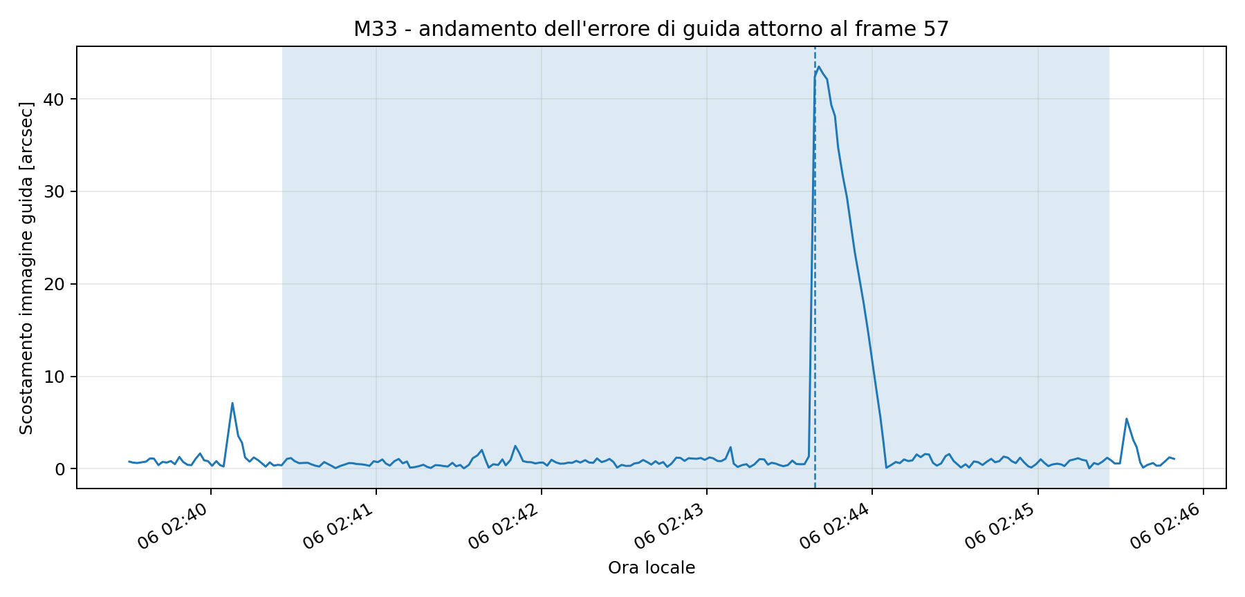

The problem occurred during Autorun frame #57, a 300-second exposure.
The exposure started at approximately 02:40:26 local time.
At approximately 02:43:39, while the exposure was still running, the PHD2 log shows a sudden guide-star displacement of about 28.4 pixels, corresponding to approximately 43.5 arcseconds at the reported guide scale.
The excursion was mainly in DEC. PHD2 then issued repeated maximum-length DEC corrections (400 ms) and eventually recovered.
What I find unusual is:
there was no dither at the time of the excursion;
the previous dither had completed more than 3 minutes earlier;
the next dither occurred only after the 300 s exposure had finished;
the guide star does not appear to have been lost: star SNR remained around 44–47 and the PHD2 ErrorCode remained 0;
I did not touch the mount or telescope during the exposure.
When I noticed the problem in the ASIAIR app, the displayed total guiding error was still around 15 arcseconds. Reviewing the PHD2 log afterwards showed that the peak excursion had actually reached about 43.5 arcseconds before recovering.
The affected 300 s light frame had clearly trailed stars and had to be discarded. All the other frames from the session were usable.
