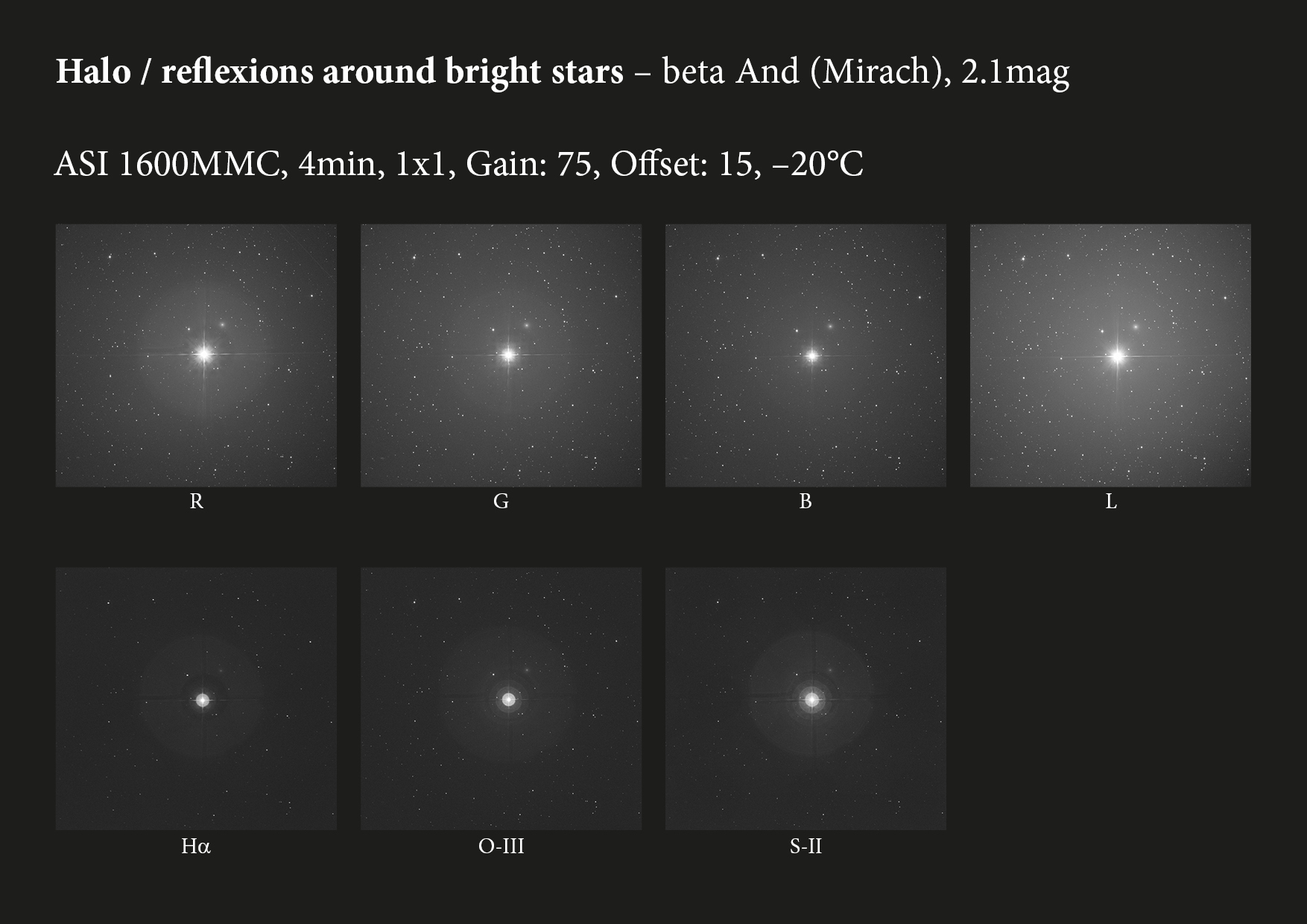

Hey Stephan,
I actually did take an image without a filter inline and the star looked perfect, no hint of a halo. One thing I did
notice last night was after turning the filters over there was a huge bright halo that appears to be bad vignetting except
the corners are still dark. I didn't really catch it the 1st night as I thought maybe I was having an issue with dew. So I
Turned the filters back over last night and will test tonight. The halo appears on the OIII and SII filters. I'll post some pics
tonight or tomorrow.
