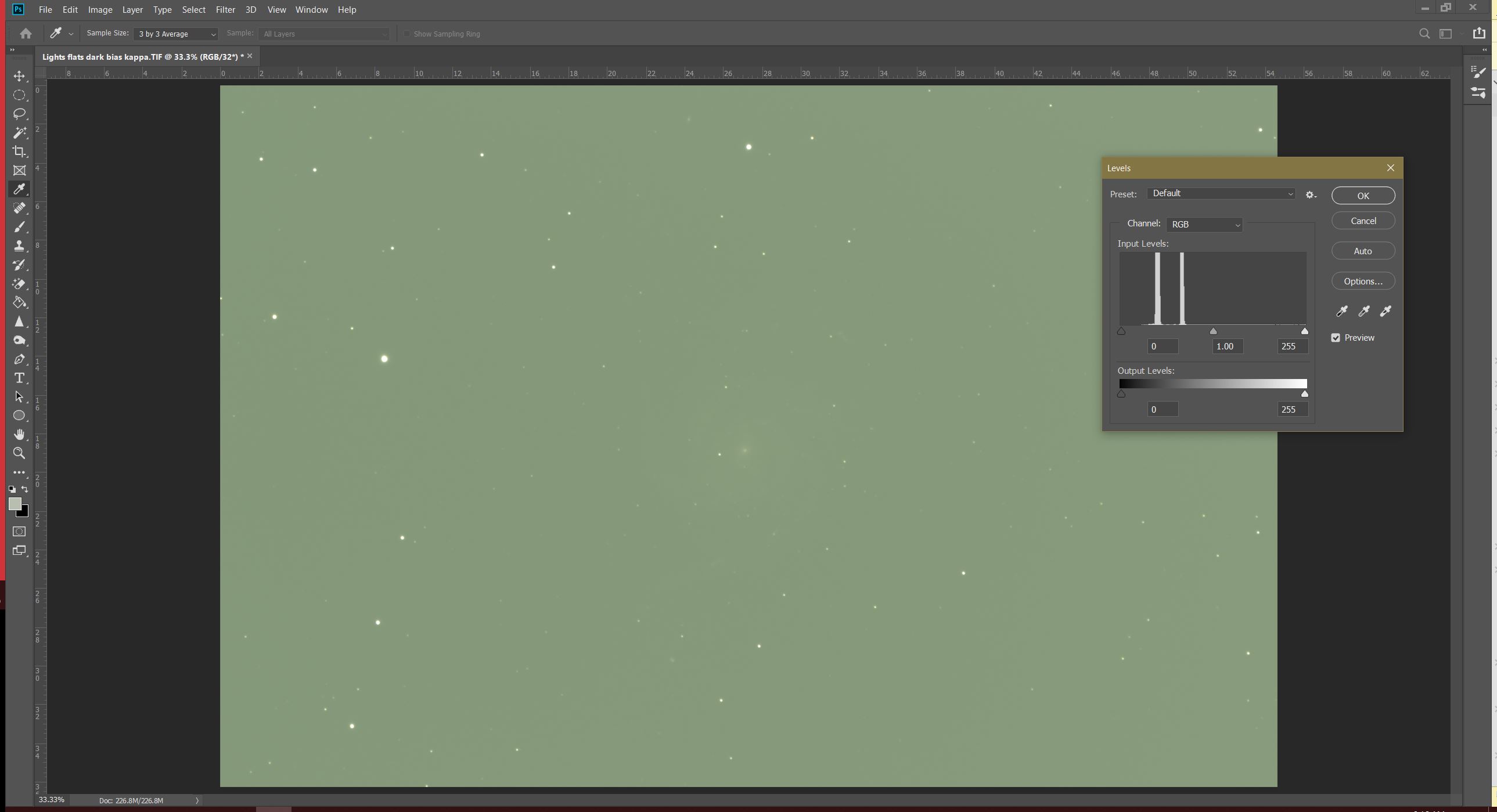

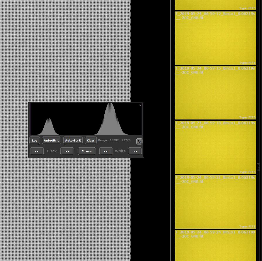

I've been attempting to transition from my T6i DSLR to the 183 color camera. It has been extremely frustrating. I have a zillion questions but figured I'll go slow and work through my problems. I'll start with what I perceive as a 'yellow cast' to my images. It is most obvious in the flats that I shoot. The histogram has two humps. (see image below)
The two hump histogram returns in the first stretch done after stacking:
The color cast is also apparent when using the camera on daylight views of trees using short exposures. Equipment is a Vixen AX103S (825, f/8). NO FILTERS. Celestron OAG with Touptek guide camera. I use Astrophotography Tool, DeepSkyStacker, and Photoshop (with some dabbling in StarTools). I shoot in a Bortle Zone 8-9. I've been concentrating on M101 for the last few weeks.
