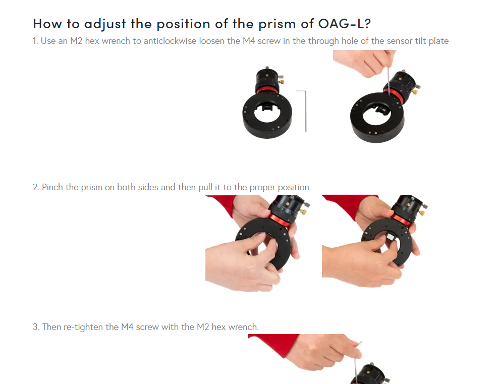

For the first rough focus, I set the OTA on a table in the house looking at as distant a target outside in daylight hours that some fine detail feature (trim/louver/high line wire, etc.) that I could use to focus the OTA on with its autofocus routine that used contrast.. Yes, the prism depth in the OAG is the rough focus adjustment. If you shove the guide camera all the way down and still not in focus, loosen the grup screw and move the prism in a MM and rinse repeat. I had to do this a couple of iterations before I was able to find the guide camera was within adjustment range.
I had the OAG-L focus adjustment set at midpoint. My goal with the prism depth was to leave around 1mm or slightly more 'gap' between the guide camera and the bottom of the OAG-L camera well to provide some additional space for course adjustment if it became necessary. I used the find adjustment to get as good a visual adjustment on the landscape feature I was targeting as possible. That puts the OAG-L/Guide camera in a good starting position for the final "tweak" on a star at night.

The only thing I dis the OAG-L/ZWO on is that the prism shaft grub lock screw is behind the tilt plate and thus inaccessible unless you dismount everything, make the adjustment, and reassemble and iterate the focus test. I don't have one, but from what I've read, this is not an issue with the QHY OAGs. I came so close to dumping my ZWO setup after my bad experience/bad quality of the ZWO standard OAG. So the lock screw location being my only issue with the OAG-L is a big accomplishment.
