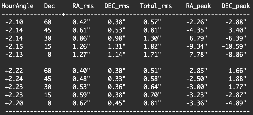

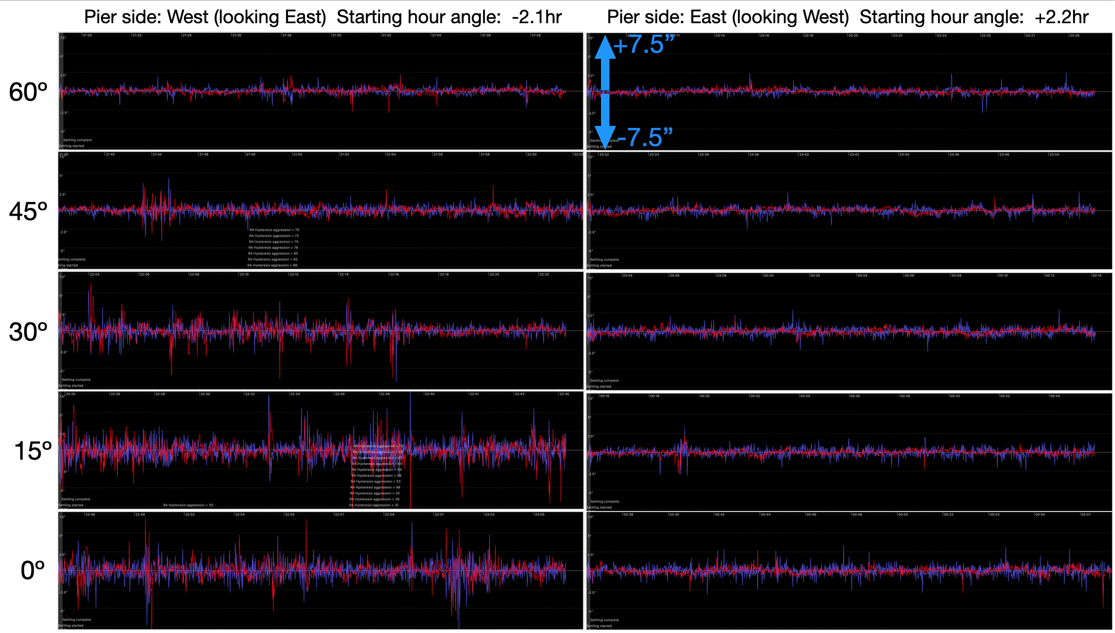

Here is the detail of my test. I point the scope at 10 different coordinates, 5 on each side of the meridian. The DEC angle is 60, 45, 30, 15, or 0 degrees. The starting hour angles is approximately -2.1hr or +2.2hr. The guiding lasts 20 minutes at each location. The rms and peaks are summarized below:
As you can see that the guiding before meridian is pretty bad except for DEC=60 and 45 degrees (but for 45 degrees, there are periods of bad guiding. See plots below). After meridian, the guiding is pretty good. Below are the guiding graphs of the 10 sessions. They are shown in the same scale for comparison.

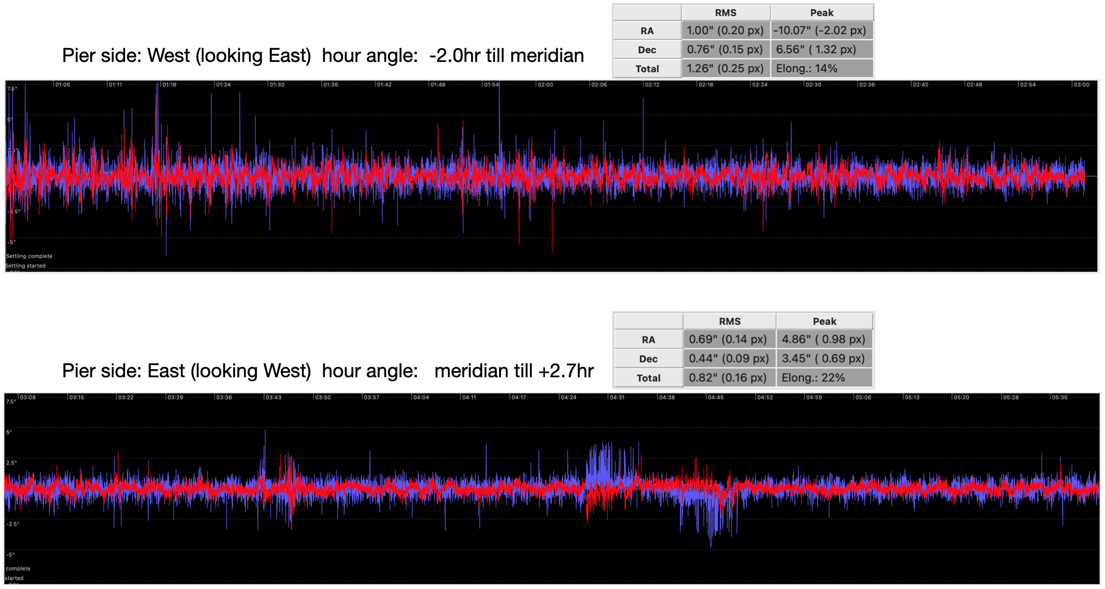

I then run a long guiding session at DEC=15 degrees from 2 hours before meridian to 2.7 hours after meridian. Here is the result.
How do we explain the east/west asymmetry?
