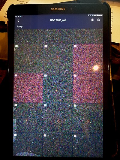

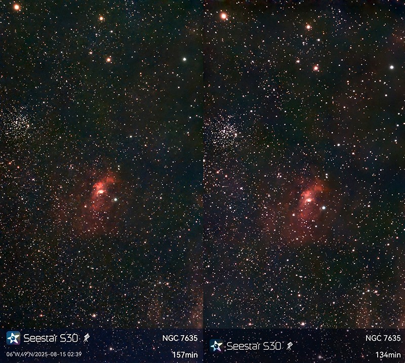

I recently gathered 157 mins of data from The Bubble Nebula. During live stacking I checked the subs and noticed several subs had a strong red cast. I attach a photo to illustrate the “problem”. The version on the right had all red frames removed before stacking in DSS. I have bortle 2 sky and no nearby bright lights. I posted this issue to a couple of groups and others have noticed the same issue. It seems it may have started after the latest firmware update. I tried doing a deep sky stack within the app and eliminated the red frames. The result was very similar to the version with the red frames so I am a little confused .

I have the latest firmwhare update installed. the one with 4k option. I have seen quite a few people saying they have seen these "Red" frames since the update. They are the subs stored in the S30. Strangely I have done a Deep Stack with the red frames deleted (Image on right) and there doesn't seem to be much difference. The only 3rd party I use is Photoshop.

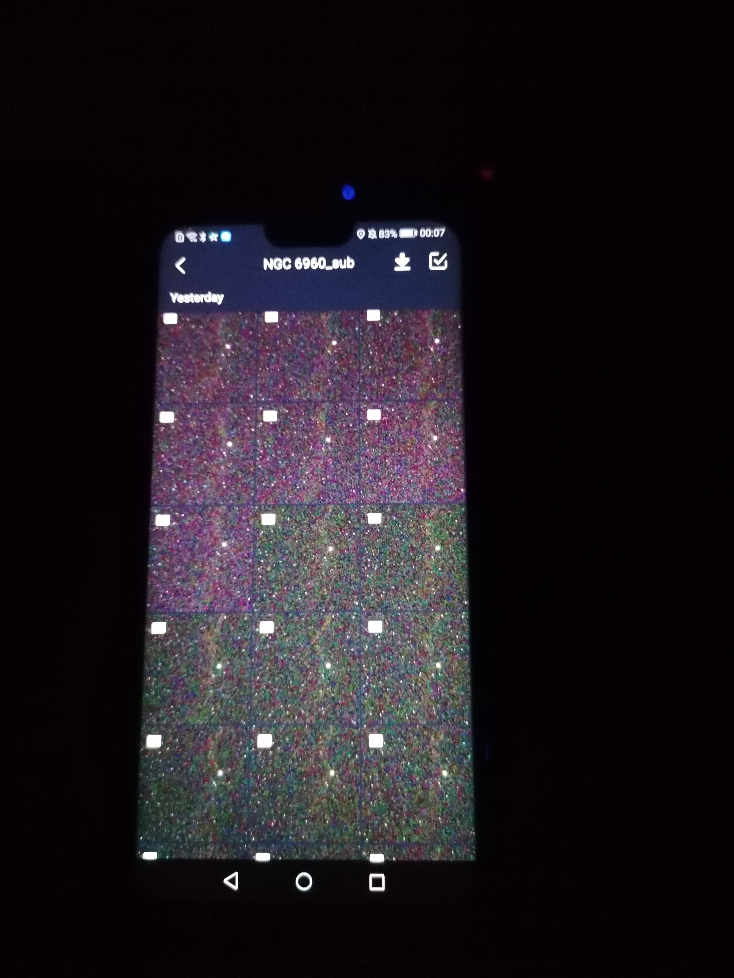

I have the same issue with my Seestar S50 using software v2.6.i have submitted a bug report via the app and now waiting to hear back. Never had this before v2.6.no lights or light pollution was present. Will update when I hear back
astronebulee Thank you,We will solve the problem in the soon
