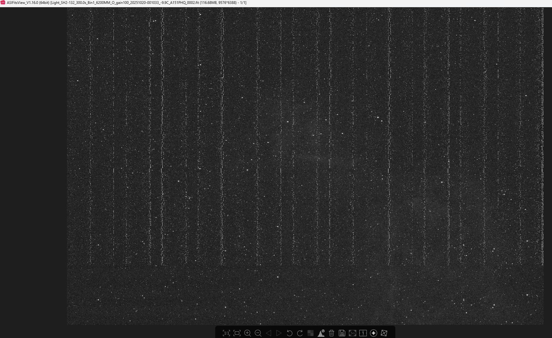

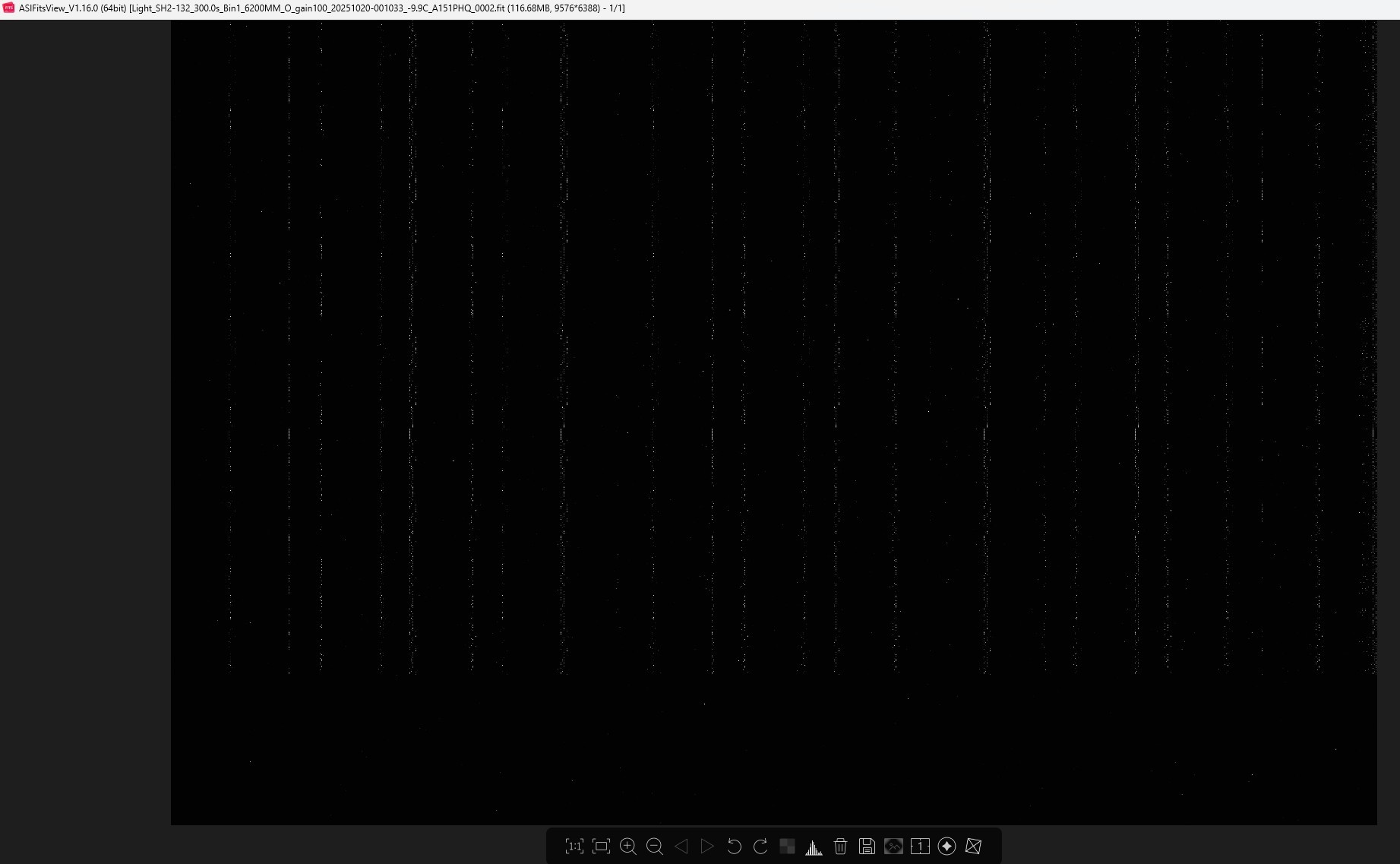

Now I'm having these artifacts on my frames when I'm shooting targets or doing calibration frames. I haven't noticed a pattern for what's causing it (i.e. light frames vs calibration frames, exposure time, gain, etc.), but it seems to be increasing in how often it happens.
See attached screen shots of the artifacts. Note that I haven't had any issues with my 2024 ASI6200MM similar to this (plus the 2024 version cools more quickly and uses less power to cool, but that's another topic). Has anyone else come across this with the ASI6200MM or similar sensor?
